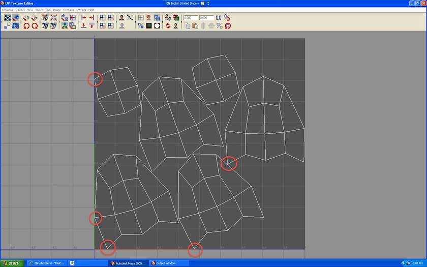

This is the UV that I need to use…please take a look and let me know if I need to fix anything.
Thank you again.

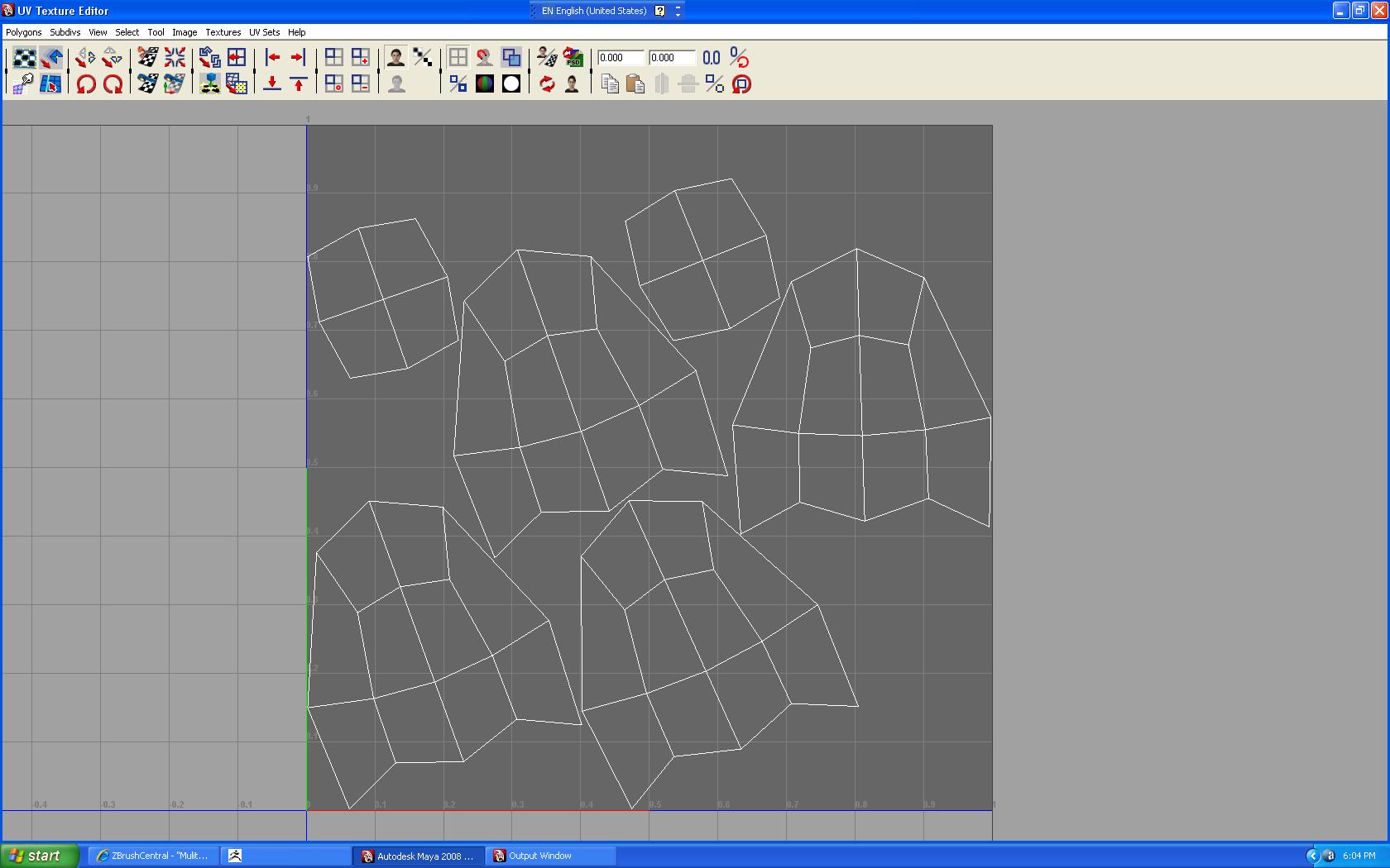

Make sure the there is a space between your UVs and the edge and between uv islands.
Some of the areas that could cause problem below.
Richard
Thank you so much for the advice!!!
As you said, I chose all the uv, and just make it a bit smaller, and everything works fine now!!
