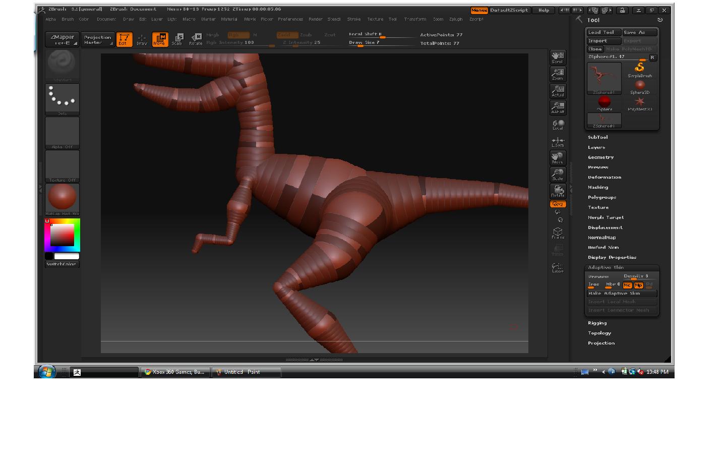

hey i started my first zsphere project and i have hit a problem.
here is the project with skin
i cant figure y there are those ridges so any help will be thanked.
idrankmy6pack
idrankmy6pack
I think one of your Zspheres in the torso may be twisted, or perhaps pushed into the hips a little to much. Try to stretch out the torso a little and see what happens.
In the Adaptive Skin subpallet of the tool pallet, there are also sliders for IRes (intersection resolution), mbr (membrane curvature), mc (minimal skin to child), mp minimal skin to parent.
You may wish to experiment with these and see what kind of skin you get.
-K
thxs for the idea Kerwin but im not sure how to fix that i tried rotating the zsphere but it doesn’t seem to be rotating so i don’t know if i have to do anything in paticuler or just start over so if u can explain how to rotate it id much appreciate it
thxs in advance
First, make sure “Draw” is selected, then in side view, select a sphere with the “move” tool and move it slightly, then hit “A” and the crease should be gone.
