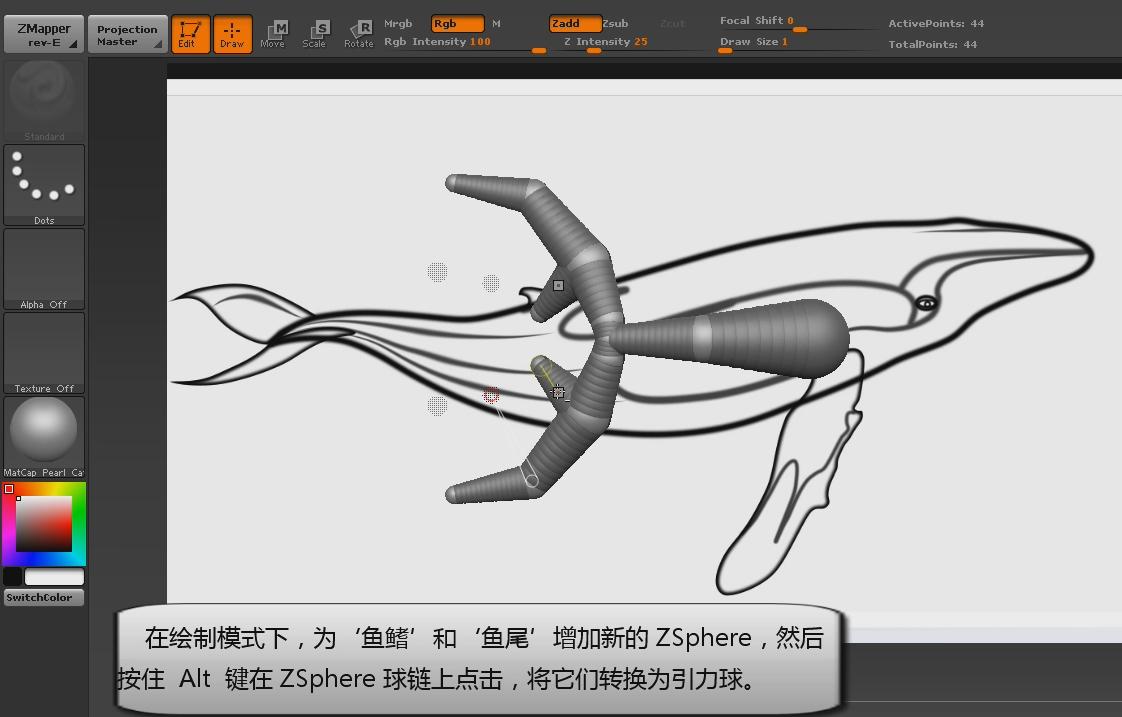

I am new this program and I want to sculpt a whale but I couldn’t make it’s tail and fins. I found a tutorial video on net a chinese guy make it and it is in chinese. So he did tail and fins very easy technique but I couldn’t understand.

well yes I found link. sorry I couldn’t find in any video sites I found only download sites. Also this technique I try to tell you is in chapter 1. he made tail and fins. then he add additional zspheres then delete them after that he turs adaptive skin tail and fins are flatten.

On the pictures below you can see this process. How can I do tail and fins like that? I delete with alt key tail extra spheres but when I turn it to adaptive skin it doesnt change.
to use magnet spheres you have to have classic skinning turned on.
hımm i think yes classic skin :slight_smile:
thank you very much
