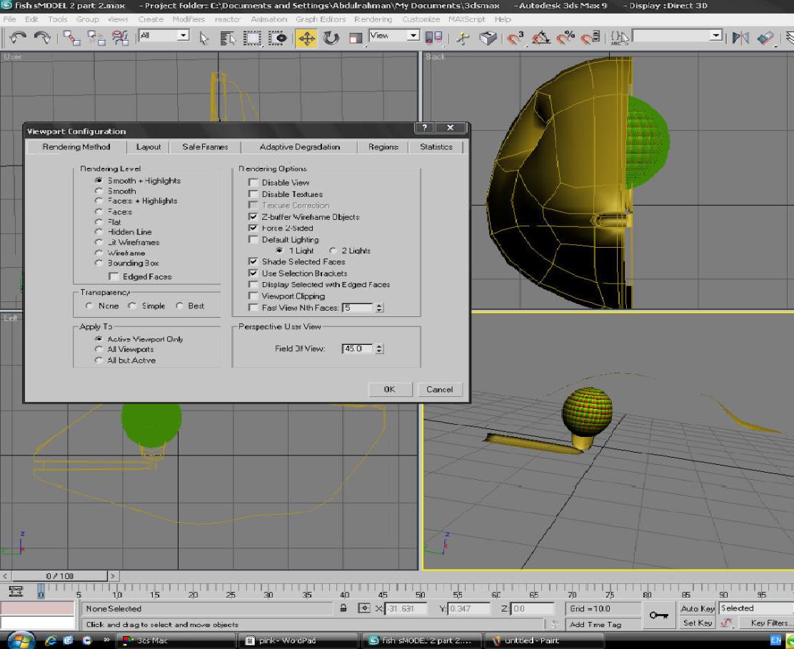

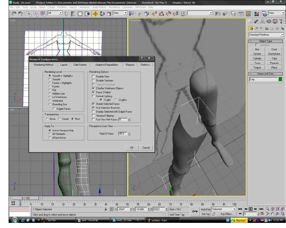

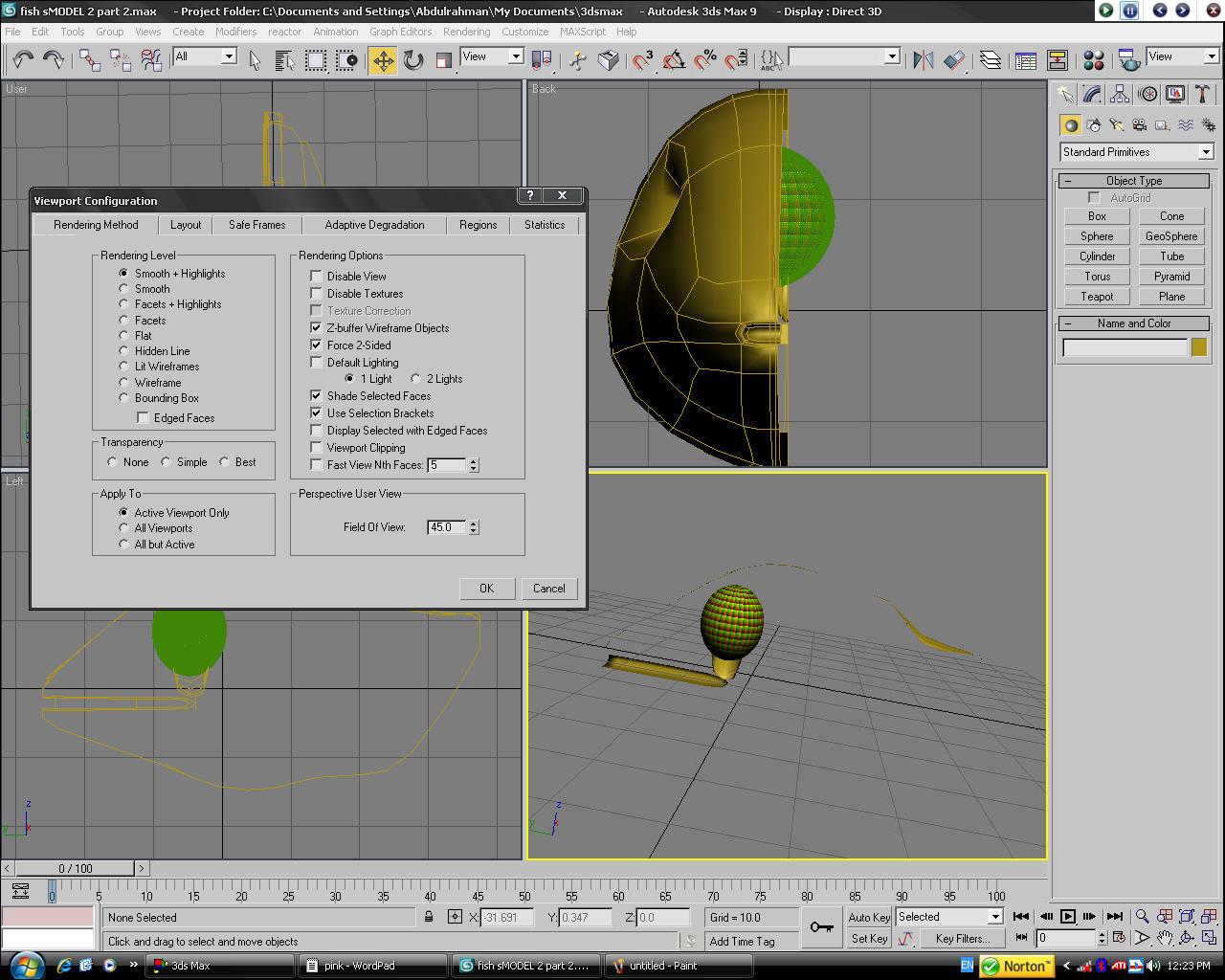

I have 3Ds max 9 & I modeled fish & chairs,but I have this problem axualy three problems problem:
1- when I click on the prespective view config & click force 2 sided nothing happens look at image 1(below).

Hi,
you’ll probabl get an answer a lot faster at the “Area”, the official Autodesk Max Support site. This could be a video card issue.
All the best,
Alan
Yeah maybe. Try to revert from Direct3D and try again in Software mode. To do so go under Preferences-Viewport-Display driver

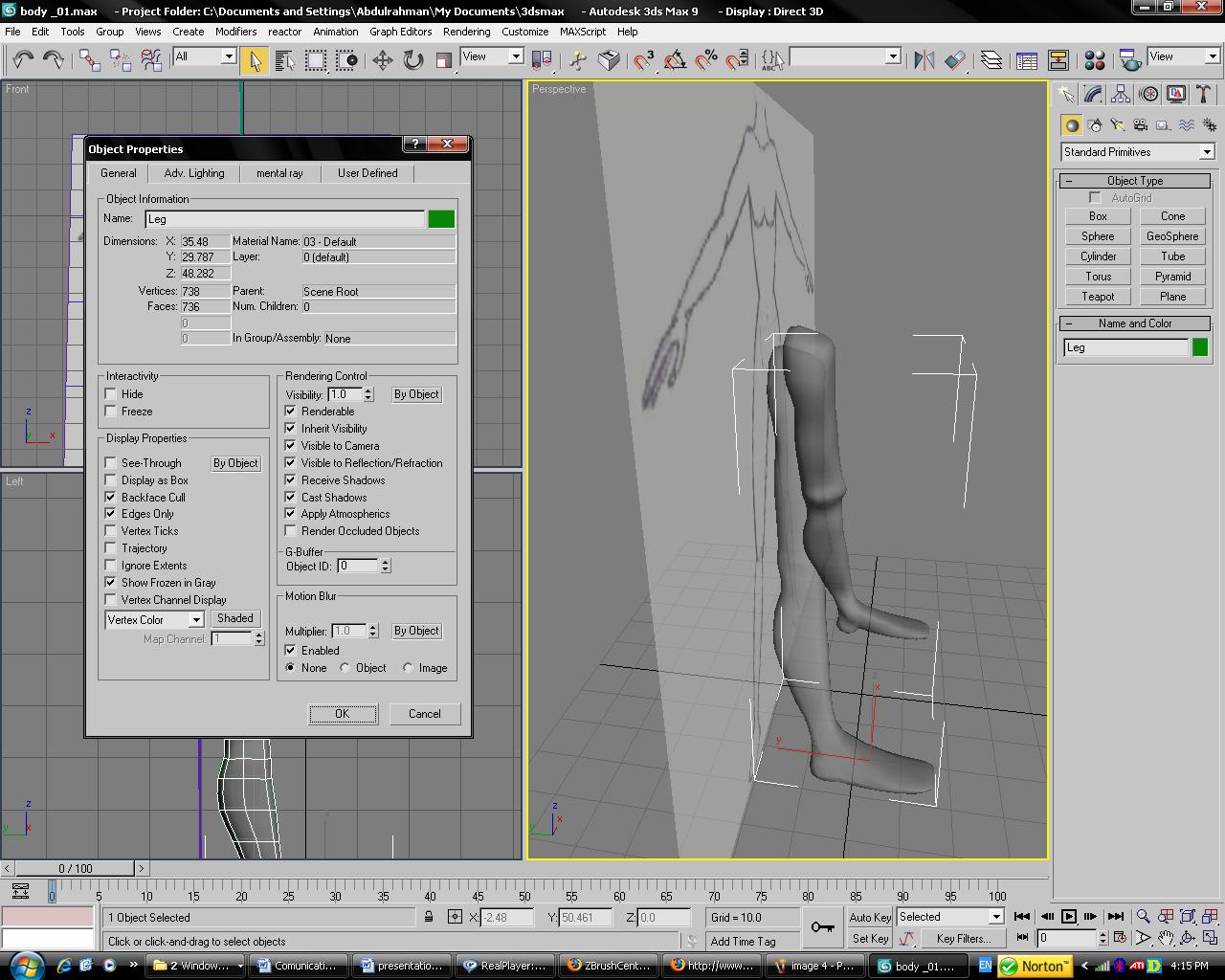

Hi Busta5000.
The problem you have is that under “Object Properties” you have the option “Backface Cull” checked.
You must uncheck it, because you don’t want to cull away the backface; instead you want to see them right?
Forcing 2-side isn’t the function you are looking for.
Please tell me if you don’t manage to fix the problem
