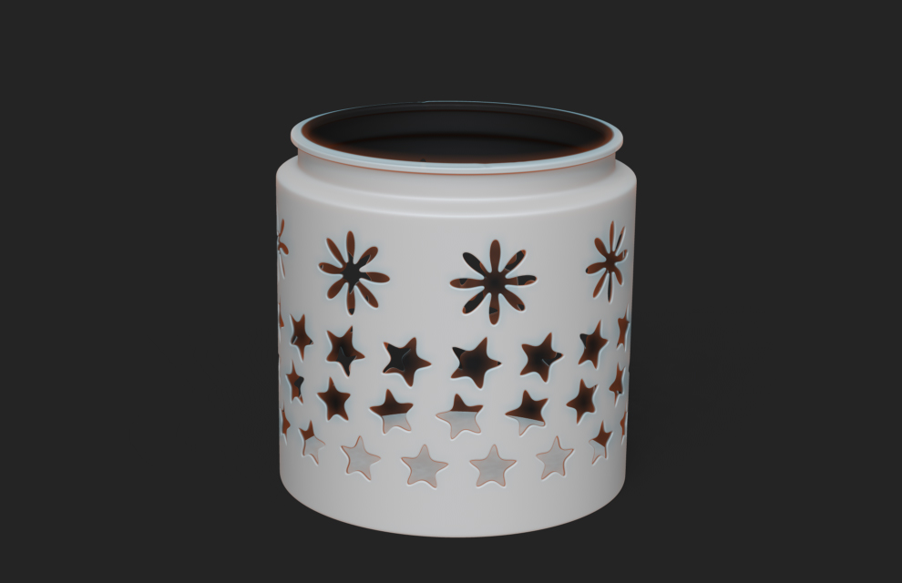

I gave one of the vases a go, using Booleans and Dynamesh, a little time consuming but this is half an hour of work and no means perfect!
Just create your base shape (from a cylinder), then paint the shape you want with a mask (with radial symmetry on). Then use extract. Done
That is beautiful. When you say extract is by way of the sub tool or deformation, i’m not clear. Thanks for your help. Your model looks beautiful by the way.
Could you please list your steps to create your model. I’m use to working in other 3d packages. You started with a cylinder and was able to hollow out the cylinder and then you used extract. A list of steps would really help me if it’s not asking too much. You have really got me excited based on your renderings. Thank you for your help, I could really use this job.
Extract is at the bottom of the subtool pallette. You just paint the pattern you want using a mask. (you could use an alpha if you want)
Click extract, mess with the settings to get the thickness you want.
Click accept, and then you have a new subtool of the extracted mesh.
You can then sculpt on it (again using radial symmetry).
My sample is crap as I tool 2 minutes do do it, just to get some images.
Here is the process I took, Gordon Robb’s one is perfect too! There are many ways to skin a vase in Zbrush!

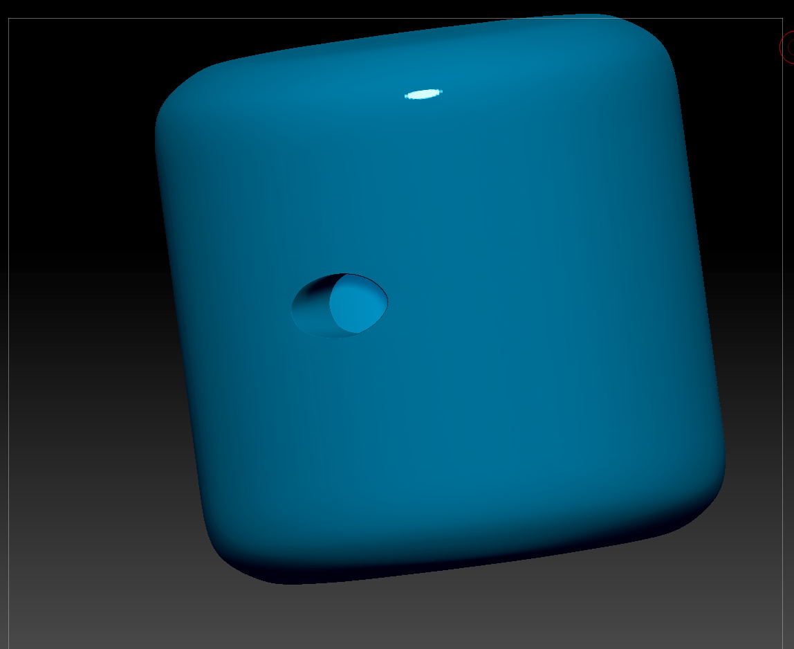

I am having trouble using the sub tool extract feature. As you can see with the images, I mask a circle. I then invert the mask. I then use extract
from the sub tool panel and I end up with a hole that doesn’t penetrate the cylinder. The hole as a back wall that is driving me crazy.
I want to end up with the example you guys showed me earlier. Please help.
Thanks.
You should have 2 sub tools the original and the extracted one - delete the original one!You could just turn off its visibility- its the eye symbol in subtools to get the same effect.
Also try playing with radial symmetry-y axis- in the transform menu it will speed things up!
Yeh, as Sprinfield Jack (awesome name) says, what you’re seeing there is both sub-tools.
I do it the way Gordon does, except instead of extracting directly from the mask, I edgeloop the mask (ctrl-shift-e) so I can polish by groups.
Then I delete the groups I don’t want and extract the rest.
