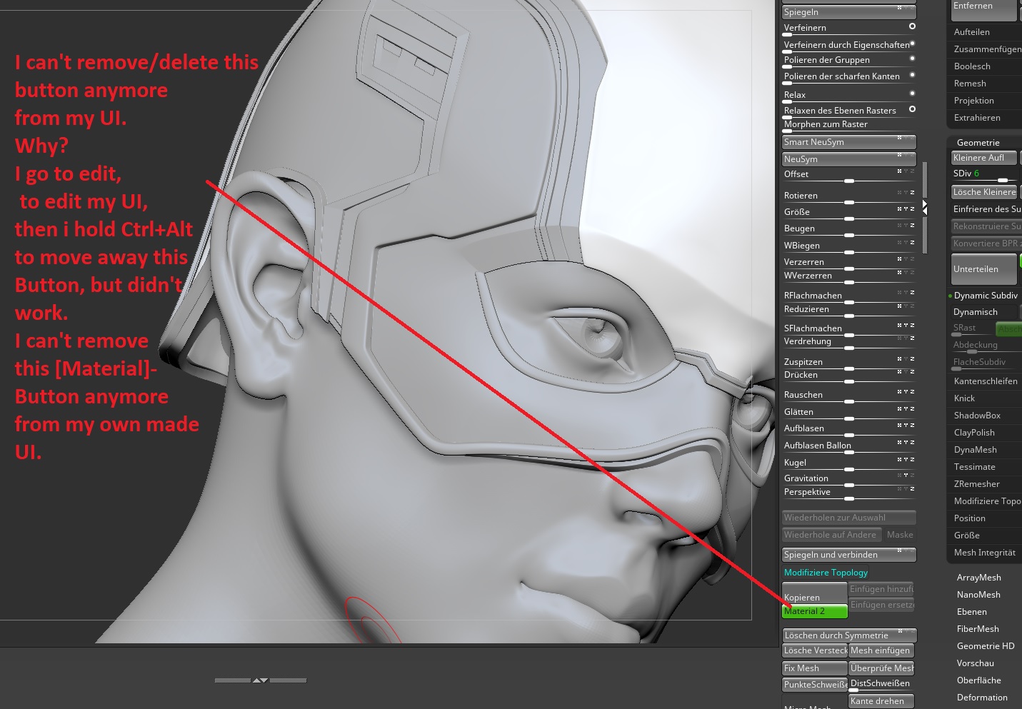

Hi, again a Problem with ZBrush.
I’ve the newst version of ZBrush.
I can’t remove it, i can’t delete it. Nothing. Its attached there.
Check:
Check:
Have you first enabled Preference>Config>Enable Customize?
Jop…
But I can’t neverthanless delete this button or move it somewhere else.

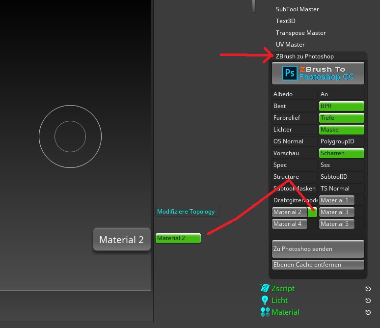

Ok,… check this now,…I found it:
But is that not a ZBrush already included plugin? Why just my ZBrush has this bug?
Here, the Plugin is from here (was this plugin not already included with the install of zbrush 4R8? - I do not remember anymore):
