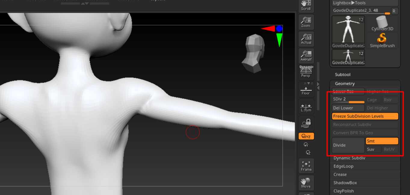

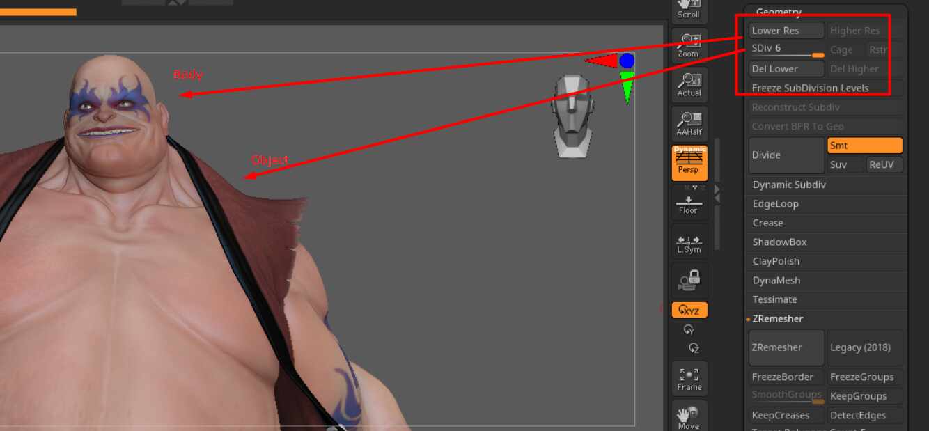

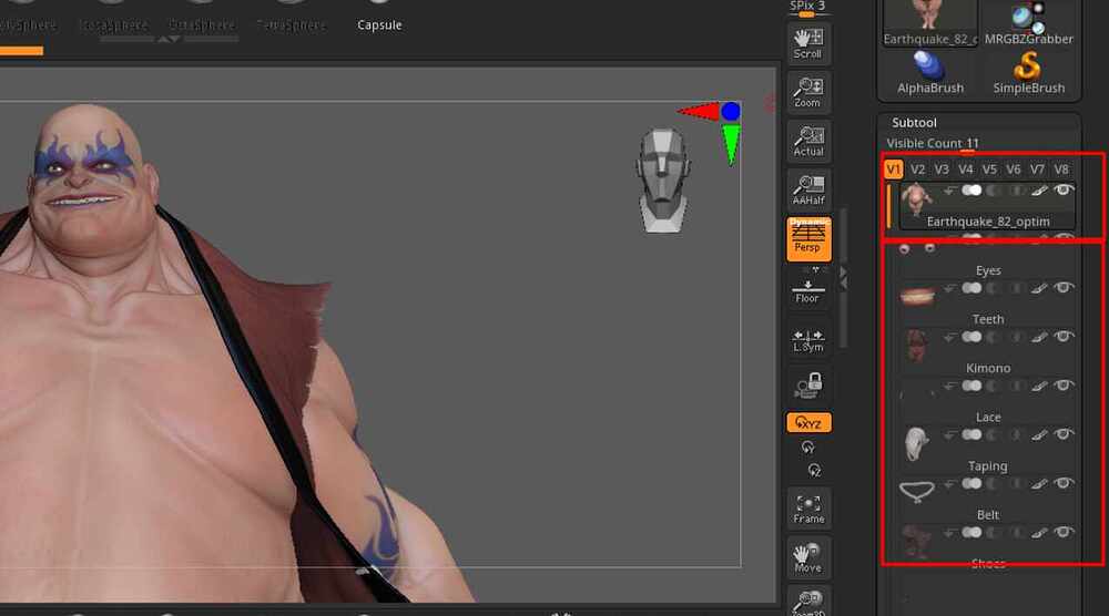

Hello, I cannot add any object after I divide my model. I need to delete the phases in Geometry>SDivide so I can add them. But I want to keep these stages. Although there are 6 sub-stages in Geometry>SDivide in one of the ready-made models in ZBrush, the dress or other object is in the layers, that is, in the Subtool section. How did he add them?

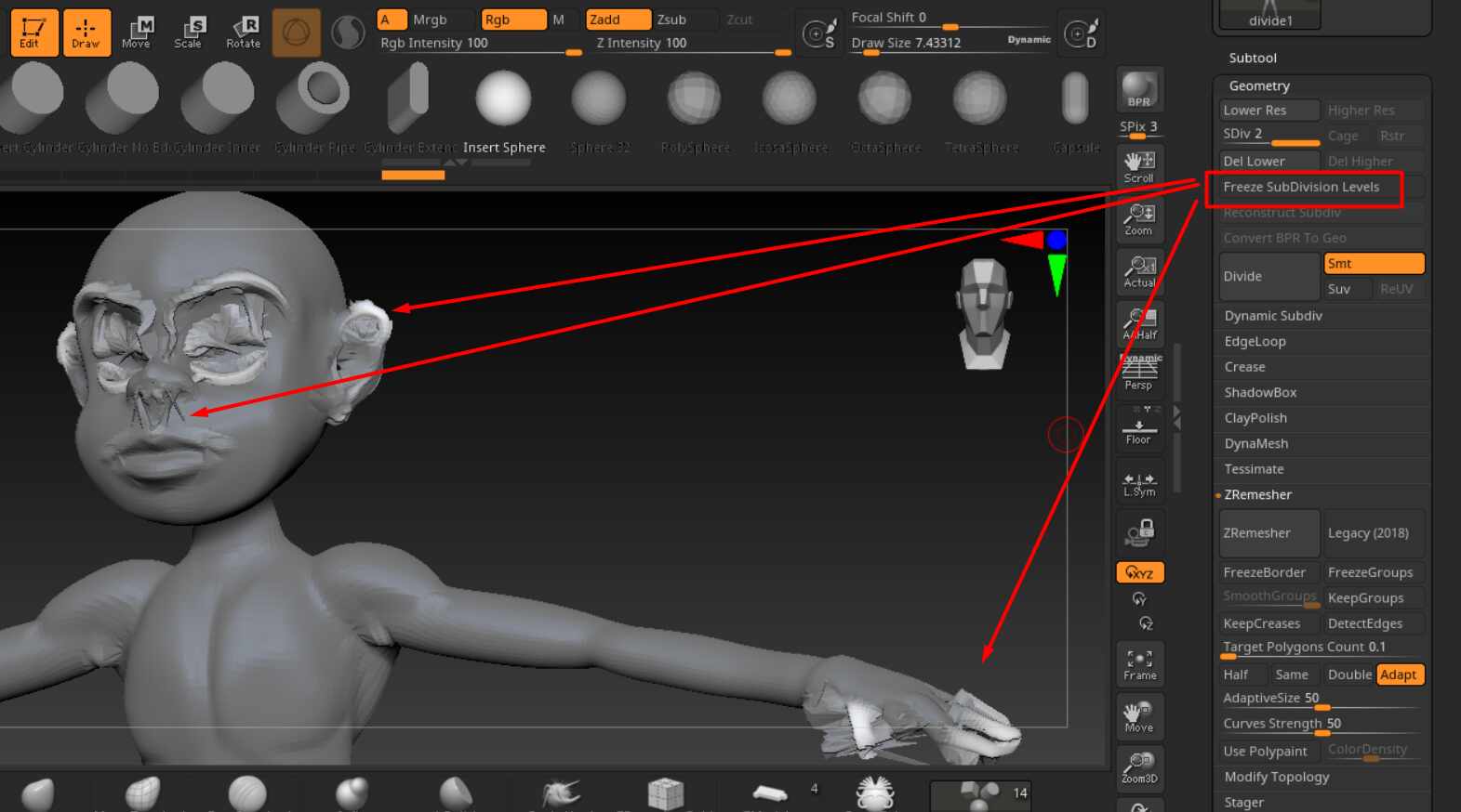

When I turn off Freeze Subdivision Levels, my model breaks down. After my model is broken, I can add an object when I reactivate it. But why does my model break? From the very beginning I created my model with Freeze Subdivision Levels active.

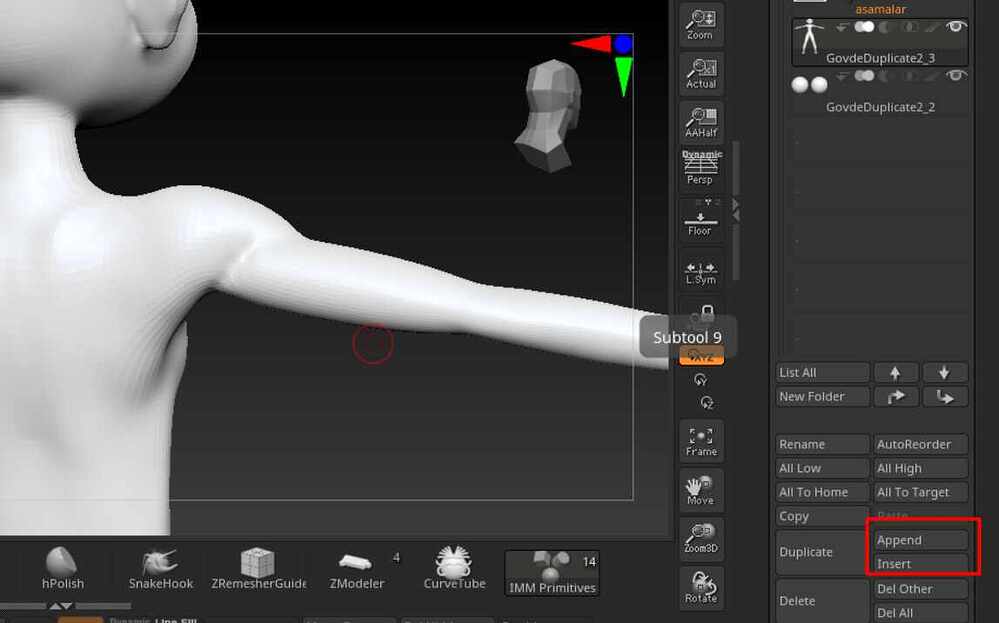

Make sure that you don’t clear any masks before you Un-freeze your subdivision levels if using an IMM brush to insert objects. A better way might be to use “Append” and “Insert” in the Subtool palette.
I’m not entirely sure but I found the solution. Models made while the “Freeze SubDivision Levels” field is active, then break itself when we close and reopen the “Freeze SubDivision Levels” field. We need to do the designs with “Freeze SubDivision Levels” turned off.
