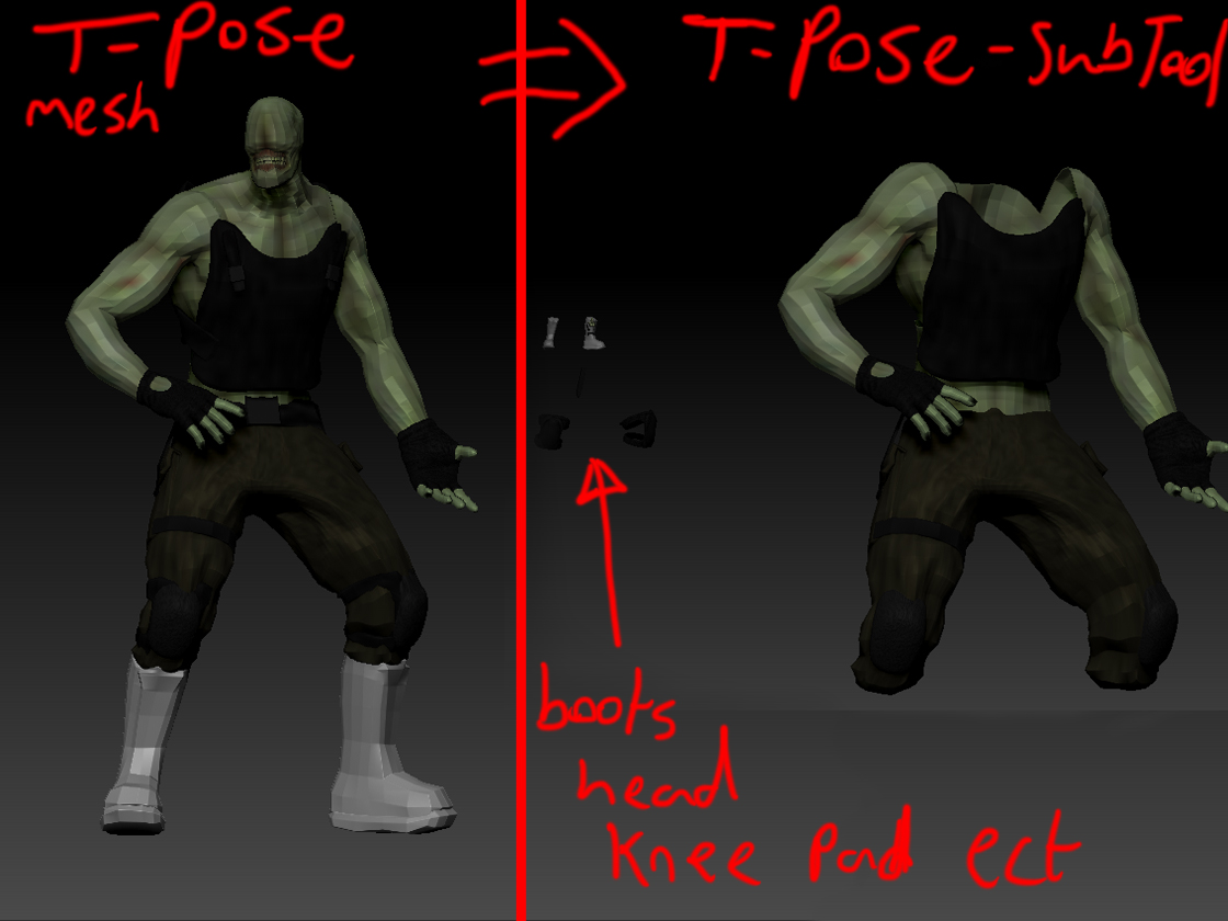

This is the first time i’ve used transpose master and i’m having a problem. I’ve watched the tutorial on how to use it and i still cant figure out whats going wrong. everything works fine untill I go back to subtools. for some reason some of the sub tools go out of proportion and off set from each other. any help would be muck appretiated.
[poo.jpg](javascript:zb_insimg(‘182143’,‘poo.jpg’,1,0))
from what i see it looks as though you have scaled your model but some of the other pieces have not been scaled.
hmm. the only thing i could think of at the moment would be to decimate the model and turn everything into a single mesh. that will scale everything
i agree with nerveink but if you use decimation masterdecimation master you will not be able to keep your topology.What about you merge them and split the group later?worth to try.

click on your first subtool, then go to export tab Set scale to 1 and all three offsets to 0.
The first tool should set the scale for all the tools, or you can set them all manually.

As the other posters have said, this is most likely an export Scale/Offset issue. You can use the Scale/Offset function of SubTool Master to set all subtools to 1/0, though if the scale of your model is important for use in another program you should note down the values from the Tool>Export>Scale and Offsett sliders first, so that you can restore them later.
You should also set the TPose combined mesh Scale/Offset to 1/0 before trying to transfer the pose.
thanks for the help guys it worked a treat. looking forward to getting this one finished and posted soon.:+1:
