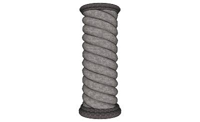

I am trying to create a spiral effect on a cylindrical part of a model I am working on. I tried using radial symmetry and dragging a diagonal line down the cylinder, but i can’t get it to be continuous and the breaks are very noticable. Is there a different way to create this effect or rather what is the best way to make this effect?

I would use tool > deformation > twist
This might help.
To model it myself as opposed to using an insert mesh someone else designed… I would use the curve tube snap brush with radial symmetry down the length of the cylinder and then use deformations twist… I’m sure you probably figured out something that works for you by now though
