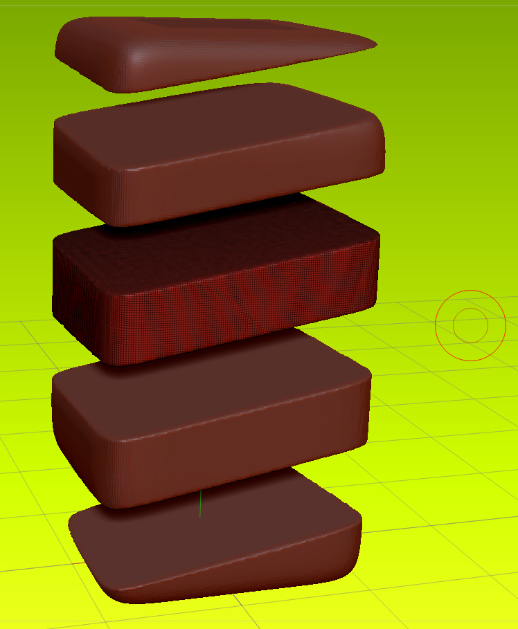

went good, worked. I am testing this with a sphere so I made some cuts, hit, group split and xpose and it came apart but now I see the outside of the parts and the inside of the mesh is open faced. as in I can see thru. in the video I remember him making cuts and xpose and I saw closed face mesh surfaces on the inside. what am I doing wrong?
THANKS …alot
edit: so I selected a piece and clicked on “close holes” and that worked but it was not a flat cut along the slice it was concave. I know im doing something wrong still

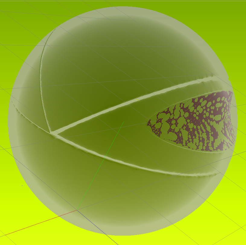

next. what is this crazy slice of digital goodness coming from is anyone else getting that from sphere slices? just curious its not a problem. thanks
You can slice without using dynamesh too. Make sure you either have no subdivisions, or alternatively freeze the subdivisions (under Tool:Geometry). Slice the model, then press the Groups Split button (Tool:SubTool). Having polyframe on helps you see what your doing. The result will be two subtools, which you can then move/rotate/scale individually.
