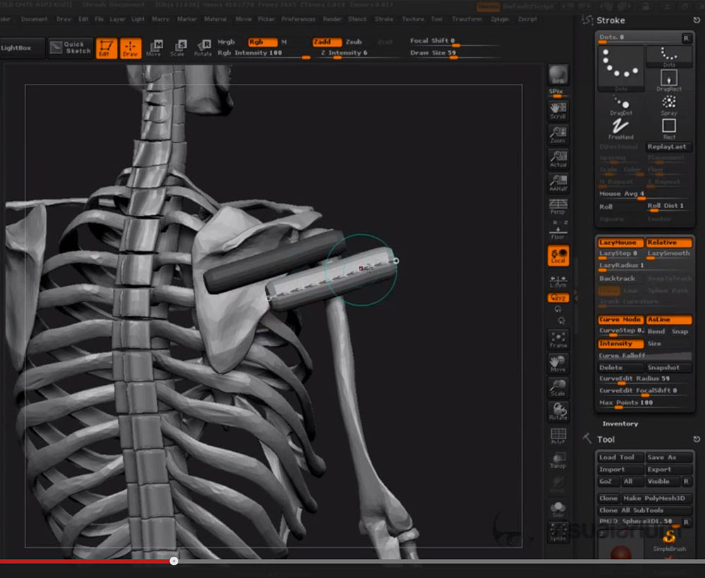

Hi!
In this video Understanding the Shoulder where Ryan freely scaled the curve inside tube.
This operation was possible in Zbursh4R2 and Zbursh4R3, but in Zbrush4R4 it changed or needs set up I don’t know about?
Could you help me please, how can I scale the Curve Tube Brush just move curve inside tube in ZBrush4R4?
Because after I drew tube, I just can move entire object!
Thanks a lot
Actually I mean this process of scaling, just moving curve inside the tube.
Ryan didn’t use Transpose tool and Bend switch off
sorry but I don’t know either, I just keep drawing tubes until I get one with the right length
