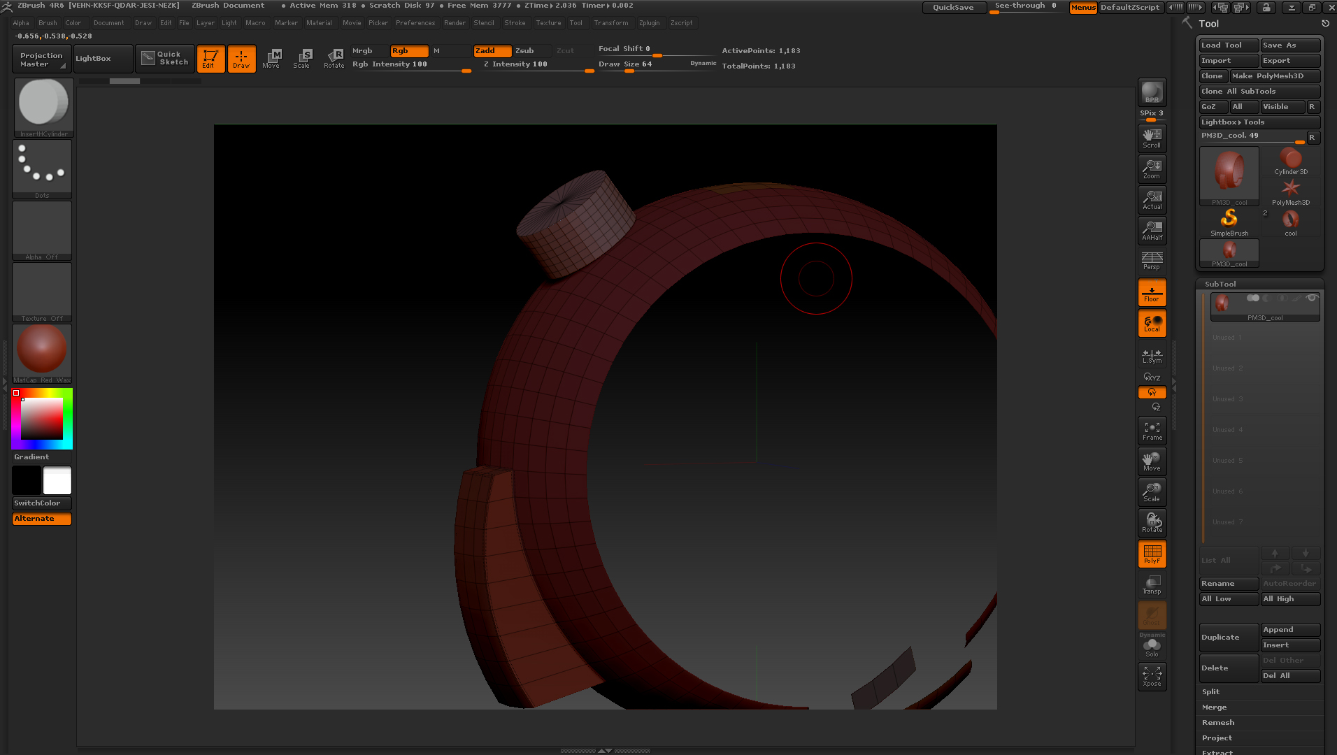

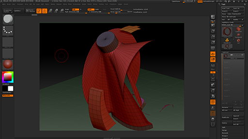

Hello, I’m currently working through a tutorial about blending two meshes together. I have run into a problem and my original mesh gets warped. I have attached a before and after of the problem I am having. Thank you for the help.

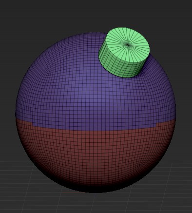

fail because the polygroup too large:1
2

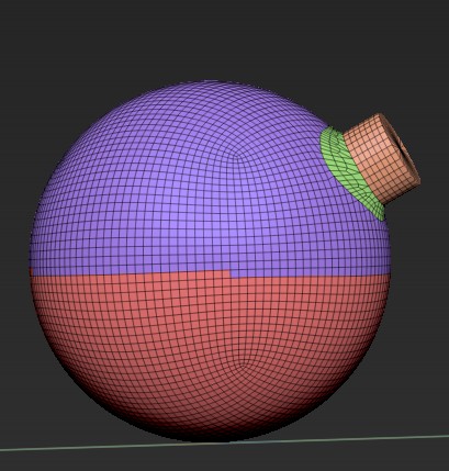

Done(only green group will be remeshed):
