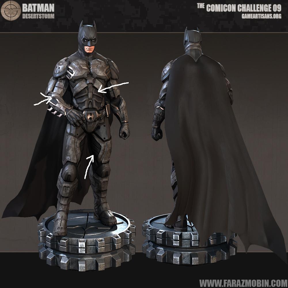

Hello,
I really want to know how to create a normal map like the picture I attached.
This is a work from a member here.
What I want to do is print hexagon mark on a body that I am working on.
I tried to use a alpha in zbrush, but I couldn’t create a clean normal map.
How can I print like this…

You can do the hex-pattern usin zbrush in 2.5d mode (dropping the tools in the canvas). With the tilde key (ñ) you can move everything inside the canvas so that you can make a seamless texture.
Once you have that apply the normal map material,and then you can export it as a psd.
In photoshop use a overlay mode for R and G channels, and a multiply for the B. That should do that efortlessly.

Search for solidsnakexxx’s “Mantis man” entry, from the superhero contest, there he explains how to do the pattern inside zBrush
