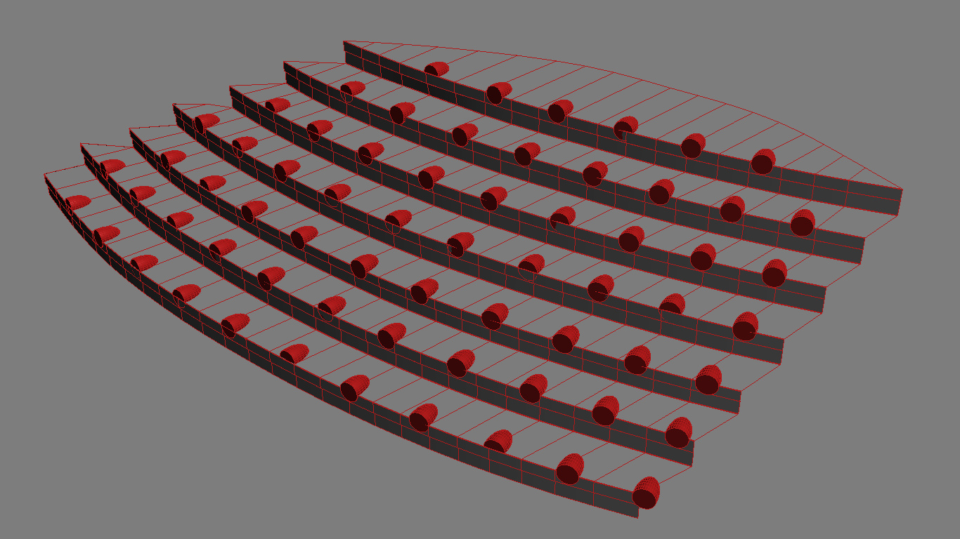

Hello, geometry which I want to modify is pretty flat and open (it’s a surface of stairs). Giving it a volume would be waste of polygons. But I want to add some form into it by subtracting geometry from a subtool. For boolean operations I have to have active Dynamesh, right? Problem is, that Dynamesh is closing my geometry damaging everything and doubling polygon amount.

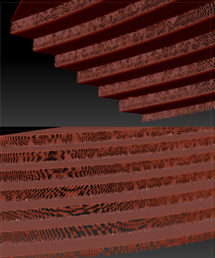

Thank you for your response, unfortunately this is an effect:
Didin’t help.
This is screenshot from max of my stairs in which I’d like to subtract these halfspheres.

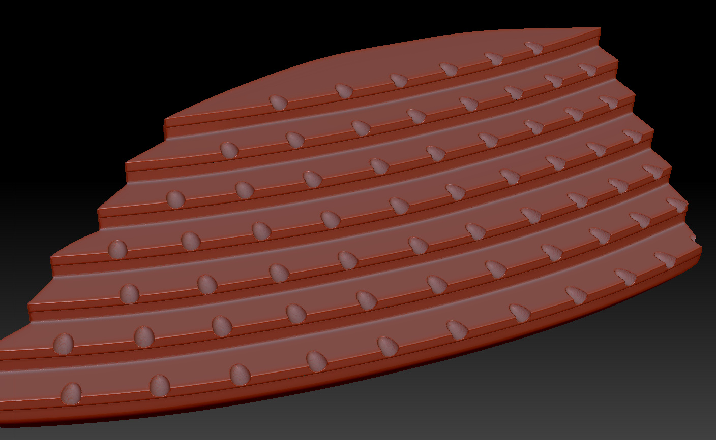

Anyway I got what I wanted, but unfortunately with geometry on the back too.
Not a problem is it? You could delete it or hide it.
there is no other way when you work with dynamesh. It should be a volume.
You can of course delete the extra geometry after you did you dynameshing or even do a localise remeshing and reproject on a copy of your original dynamesh objet.
