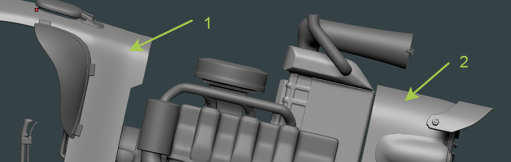

Hello. Usually subtools are highlighted when selected (1). But filled with “FillObject” comand subtools (2) do not differ whether they are selected or not.
How to reset filling?
Thank you.

Color or polypaint you can simply turn on/of or repaint it (white).
But if you fill object with Mrgb you are baking material and color so you have to “wash” it with mat. “Flat color”.
Same way: Mrgb or just M channel and FillObject
Thank you, Modos, for answer. But I can’t turn off color or polypaint (material is the same, MatCap).
Before I filled the subtool with wite color, now it remain the same hue if I select it or deselect.
Command Color -> Clear doesh’t help (probably it not intended for it)
How can I return to initial, not filled state?
