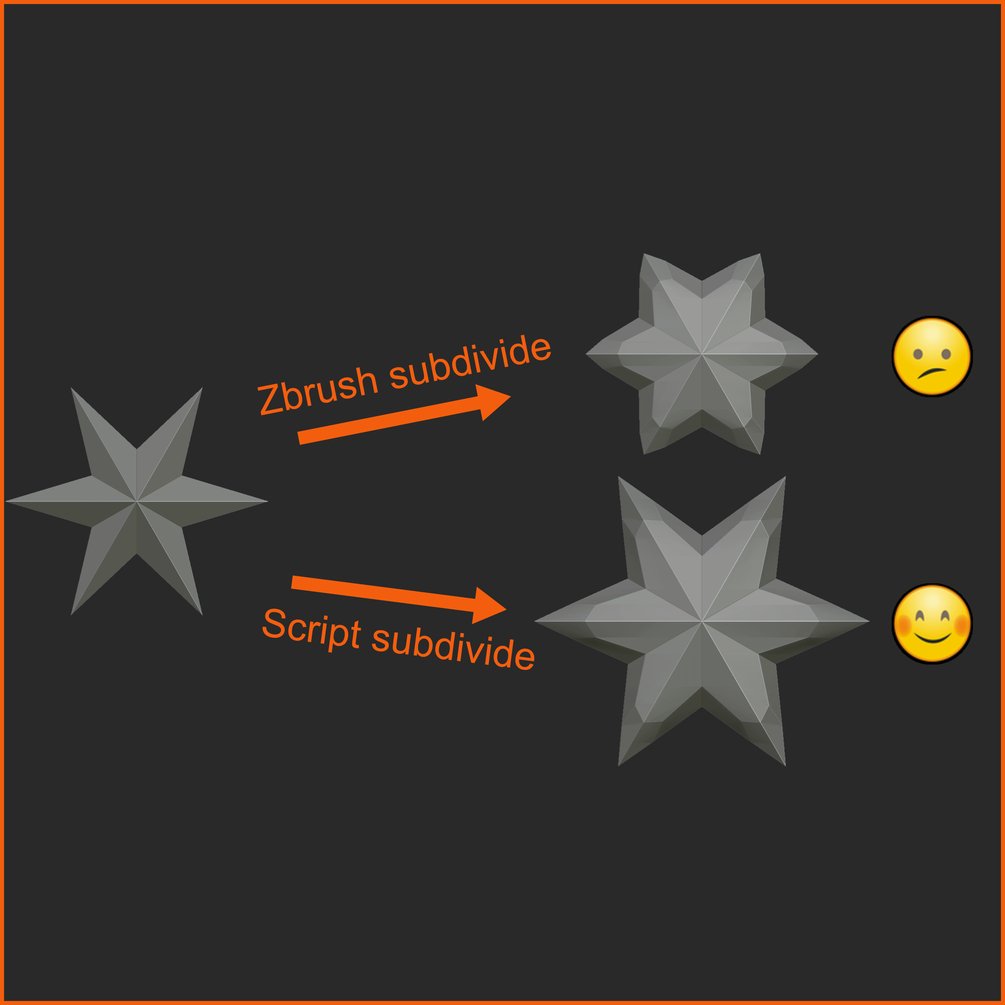

Script:
I really remember, that there was a scripted plugin some years ago (not “Nick’s Tools” but similar) which had one button to subdivide a mesh smoothly without loosing volume.
I looked through all my collected scripts but couldn’t find it again.

Hi Spyndel,
I found after more research a new script now, which I will try next time :slight_smile:

The method works fine now.
Actually the Macro script is doing exactly what was already mentioned:
Store Morph Target, then Subdivide with smoothing, then go to back to Subdiv level 1 and switch back to MT. :slight_smile:
