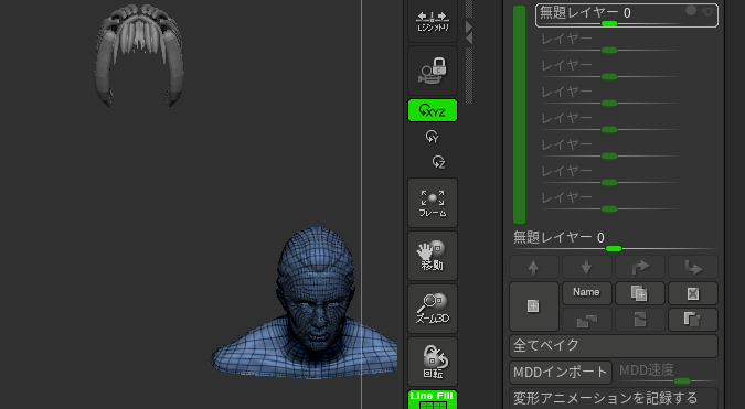

There is a layer that records the center position and the position after moving.
The hair part created at the center position is left alone.
How can I chase my hair?
I want to move my hair with me.

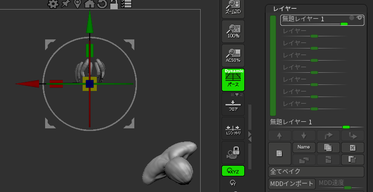

The hair did not follow the movement recorded in the layer…
It is left behind.
Sorry if I misunderstood your question. You cannot move multiple subtools as part of the same layer. A layer’s recording only records changes to the geometry of that subtool.
To be clear, you CAN use Transpose All to move other subtools at the same time as that subtool while a layer is in recording mode, but only the changes to that subtool will be recorded as part of the layer. You can also move multiple subtools at once while they ALL have an active layer in recording mode, and the changes to each will be recorded in each of their respective layers.

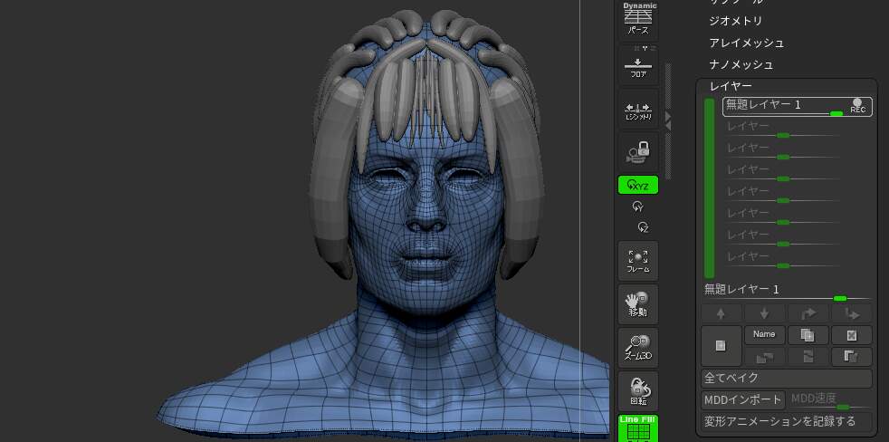

I also checked it.
http://sakakikaoru.blog75.fc2.com/blog-entry-43.html
With Contact I can reach my goals.
solved.
