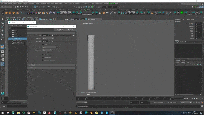

Maya move sculpt tool have 1 great thing, in brush settings than u hold ctrl u can twist model thats so useful. Can i make something in zbrush?

hello @Spyndel than u hold ctrl while using maya move brush, you can rotate geometry by brush size, relative to the camera. Its like using transpose rotate with mask but much more handy for many things

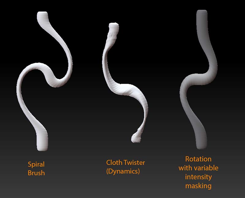

ZBrush has multiple ways to “twist” geometry. In addition to the deformer that @IsabellaZ mentioned (thanks!), here are a few other off the top of my head:
Making it an alternate function to an existing brush is another matter. You can submit this suggestion as a feature request to Pixologic Support.

@Spyndel @IsabellaZ thanks, but i know all that things) I need another brush, coz maya twist more handy and easy to control)
