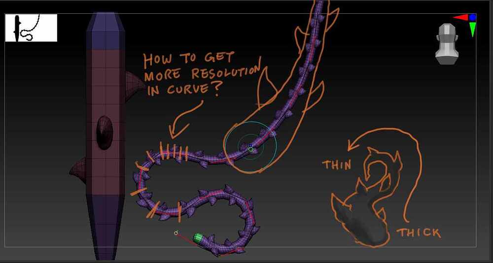

How to make an IMM Curve that is super thick to thin with more resolution in the curve?
Hello Zbrush Central,
I am trying to make a curve brush that is super thick to thin with more resolution like the image I have supplied. I am only able to make skinny ones this far and I need something more chunky and stylized like my drawing. Is this possible?
Thank you in advance.

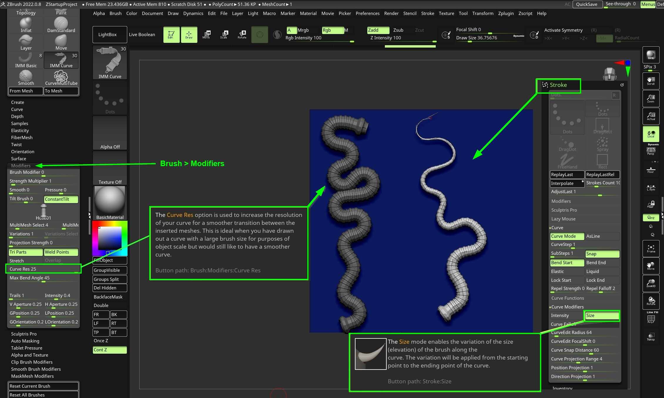

Hi @KSLR
Theses are the options you have.
Thank you so much for the quick reply. I will test this out now. :slight_smile:

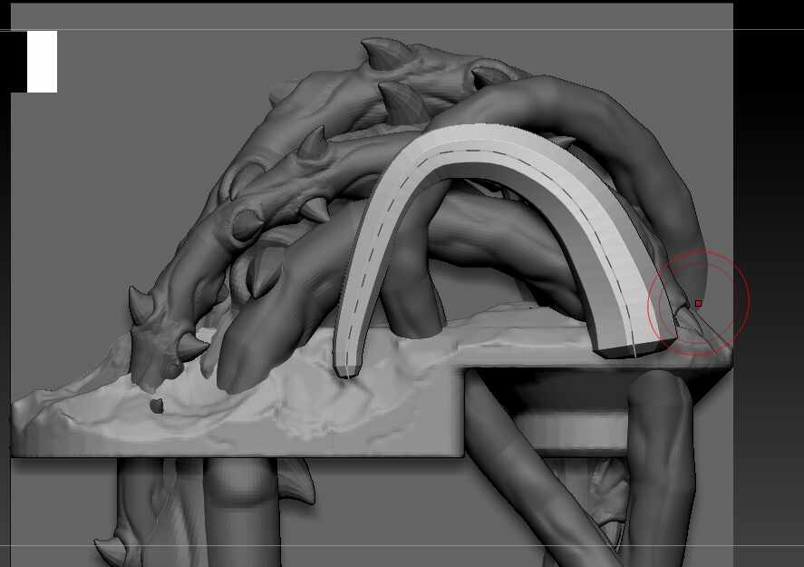

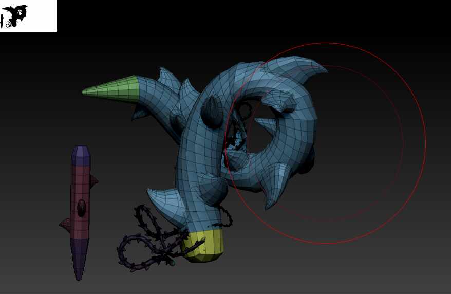

This solution works great. I think another option for me is to author the 3 pieces IMM curve to be fatter for my style since I am looking for a huge chonky boy thorn. I have to make the brush Maxed out to 100 in scale to make this type currently but then I get only a few curve points to work with. I will do some further testing but this will be good for now I think. image

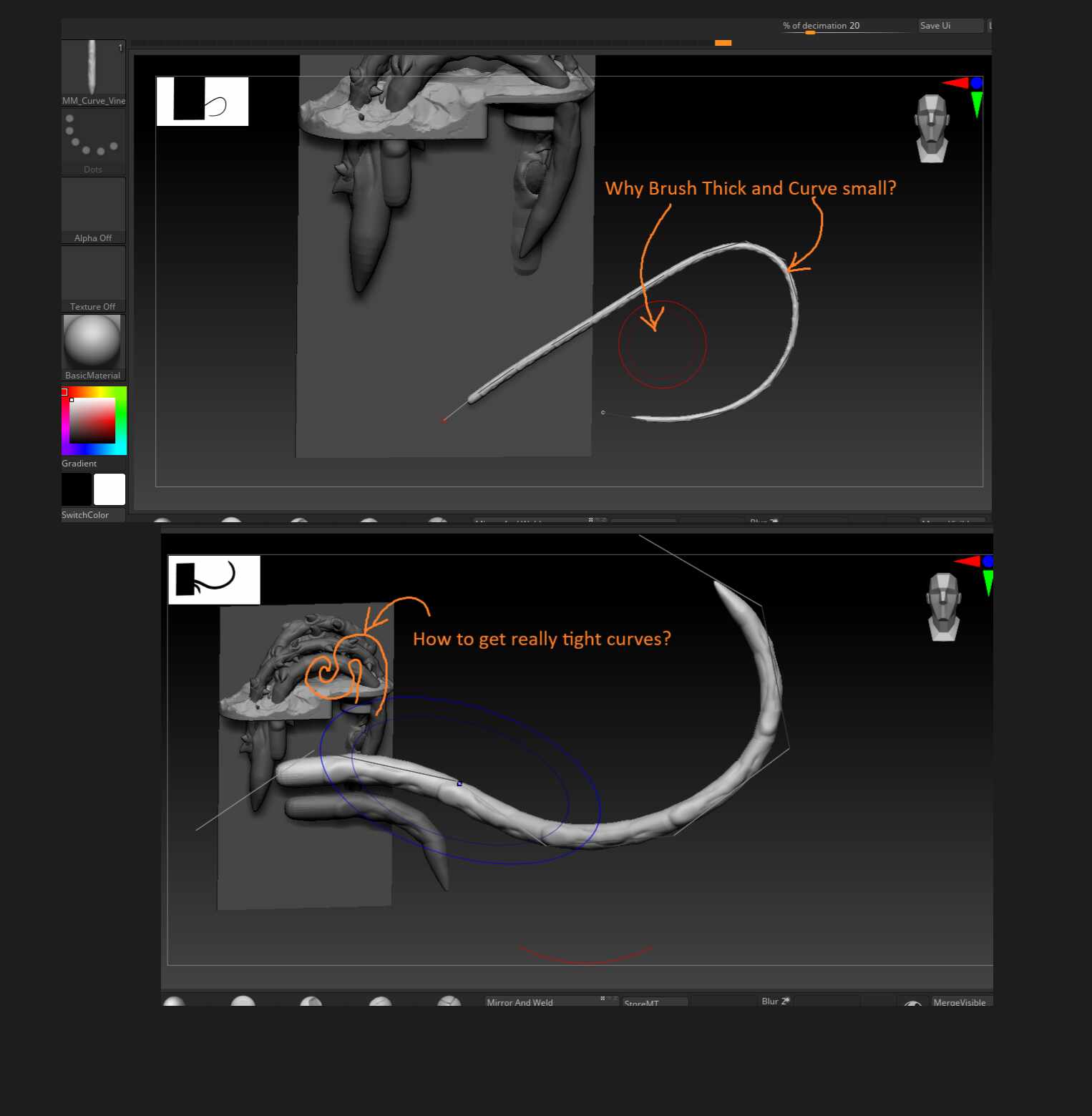

@zber2 I started getting some good results but I haven’t been able to get tight curves and the brush size has to be wildly large to get a mesh size that I want. I wan to get thick and twisty look with tight curls.
Curve Multitube seems to have what I am looking for but I am not sure what is different from what I am doing with my IMM brush.
