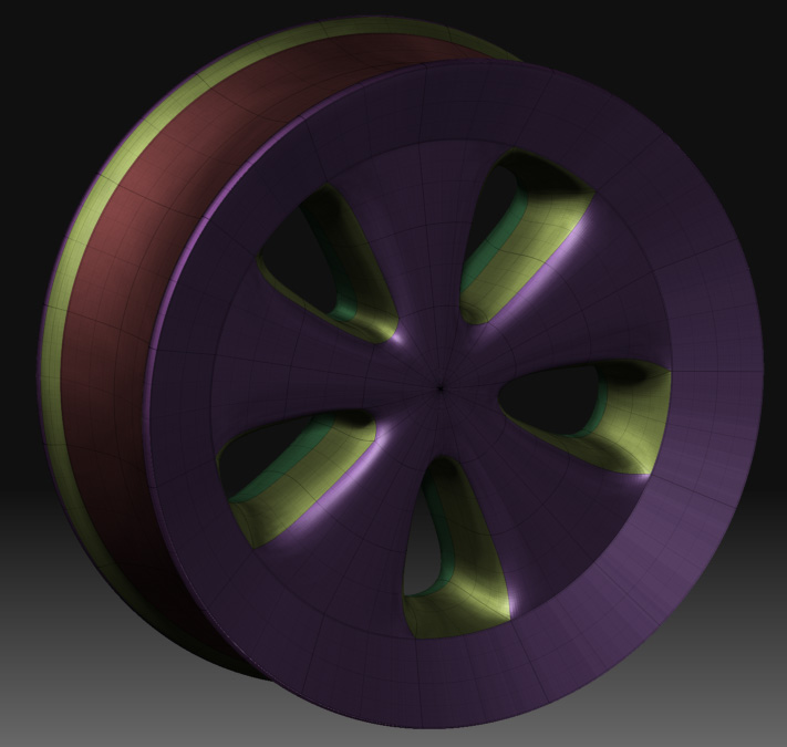

For an automotive wheel I’d still do the rubber as per the tutorial. I’d then do the inner portion/rims through the following:
  1. Select the Circle3D and adjust its Initialize values based on what will let you create the effect you’re after.
  2. Press MakePolyMesh3D.
  3. Select the new tool and draw it on the canvas. Start hiding the polygons that cover places that will be holes in the wheel.
  4. Once all necessary polygons are hidden, delete them with Tool>Geometry>Delete Hidden.
  5. Store a Morph Target.
  6. Use the Offset Z deformation to move the disk forward some.
  7. Press Tool>Morph Target>CreateDiff Mesh. You’ll now have a new tool that has depth.
  8. From here you can use deformations and box modeling (via the Edge Loop feature) to adjust the shape you your liking.
The example above is something I whipped together pretty fast (about 15 minutes) using this technique. You really can accomplish just about anything you’d like.
