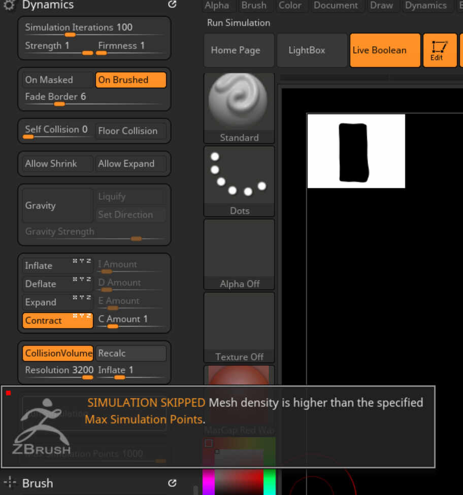

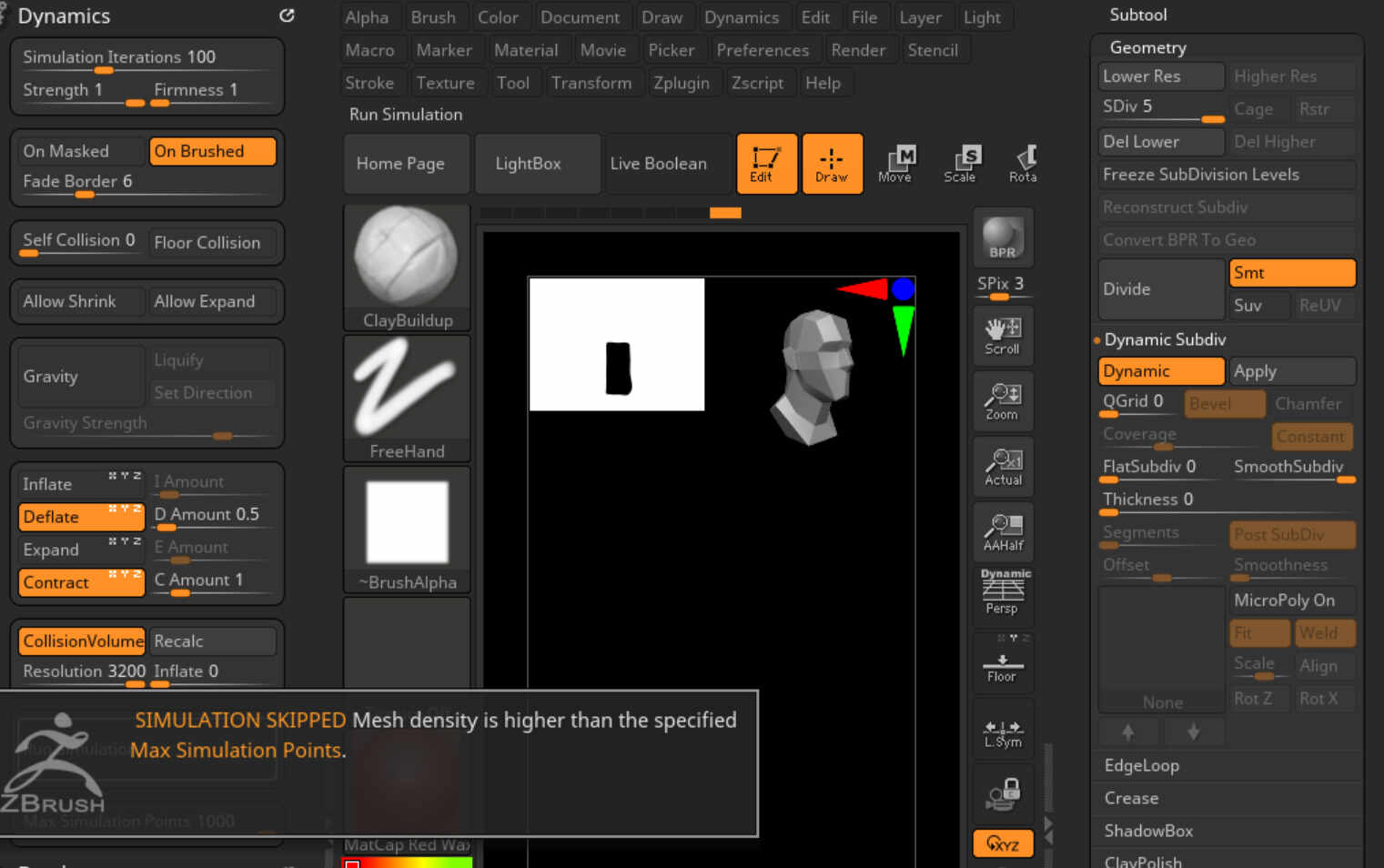

I need high-resolution of a cloth effect, but impossible to subdivide more the cloth emitter because I have this screen info :
:man_shrugging: (I have a poweful pc, 128 GO ram, rtx 3090, and amd 3970x)

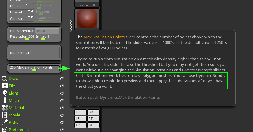

Try what is suggested in the “Max Simulation Points” slider description.
2022-04-08 08_34_36-Greenshot
I haven’t seen the description in the slider :blush:
Ok I tried but same result :flushed: (the subtool is around 1.2 million)

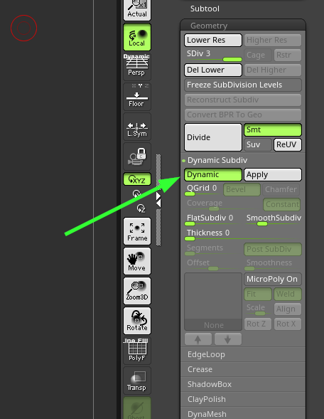

Read carefully what I highlighted in green in my first reply. Let me re-iterate. "Cloth simulation works best on low polygon meshes. You can use Dynamic Subdiv to show a high-resolution preview and then apply the subdivisions after you have the effect you want."
The Dynamic Subdiv it refers to is in “Tool > Geometry > Dynamic Subdiv”.
2022-04-08 14_40_40-ZBrush
Sure, if you look my last screen capture you can see that the dynamic button is activate :man_shrugging:

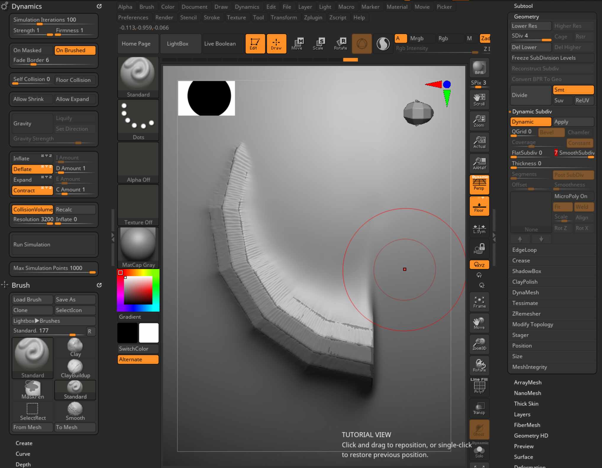

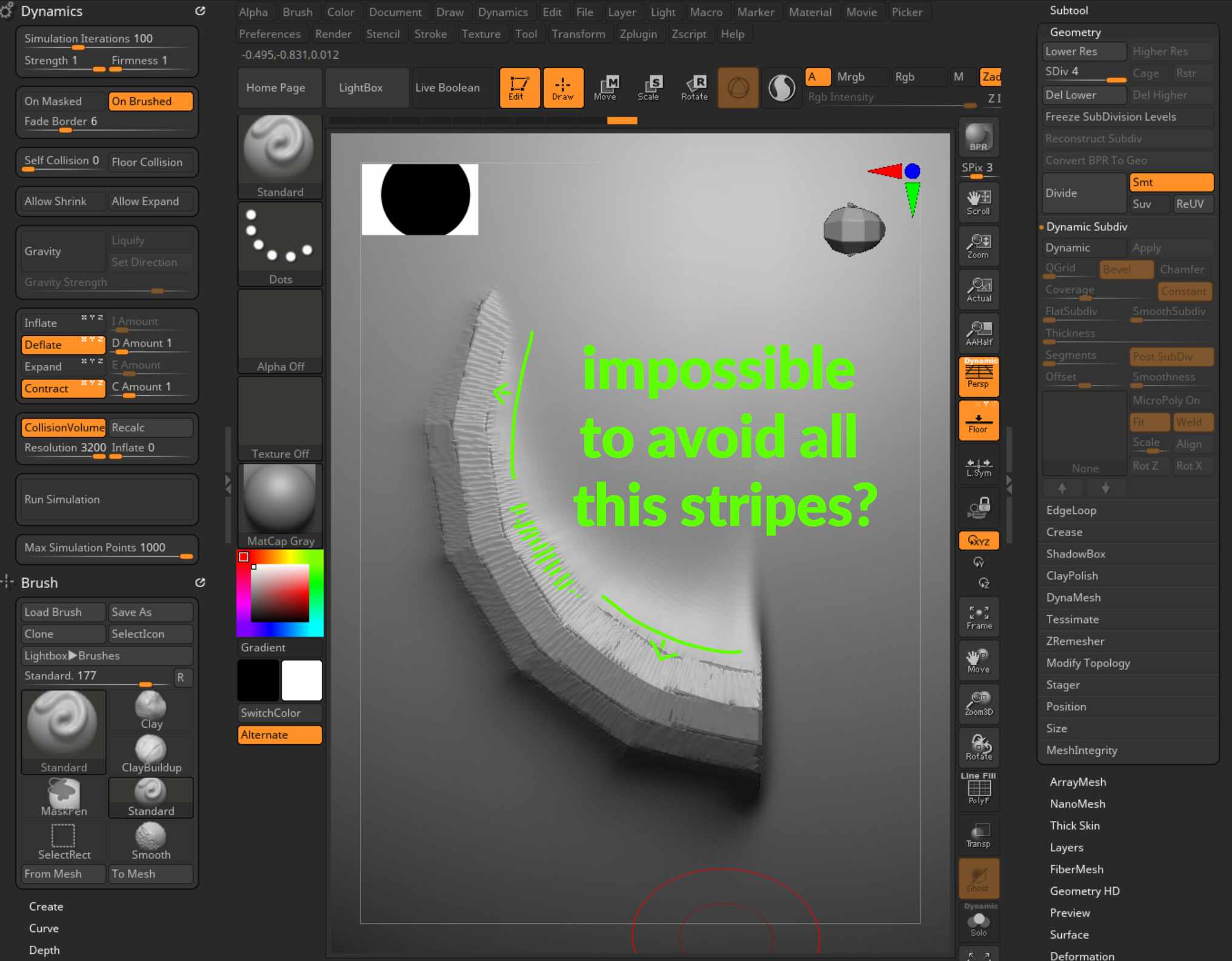

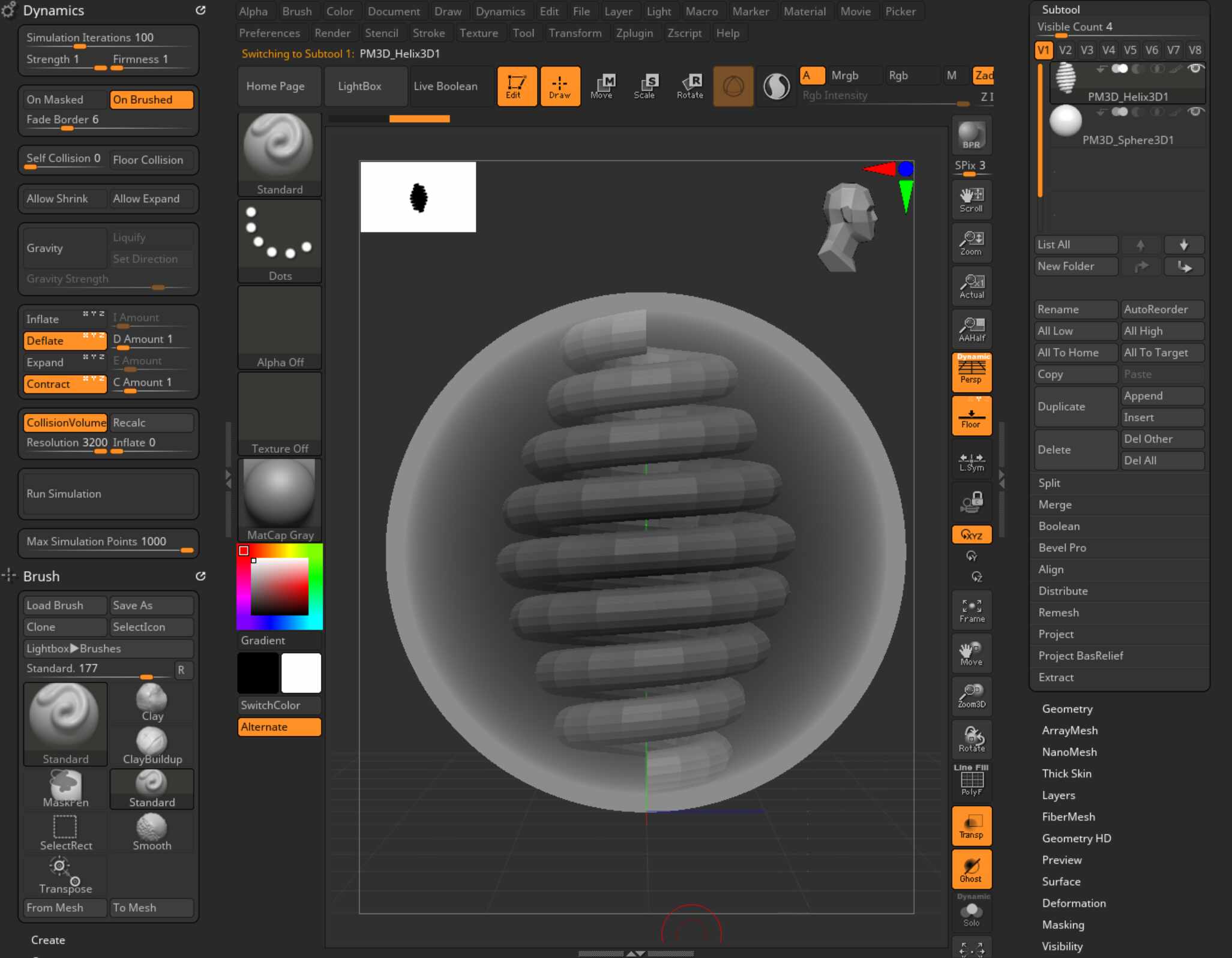

Ok so I tried again.
To show the bad result I have I made a quick scene with the sphere and helix ready to use in the subpalette.
My sphere is at 500 000, and like you see with or without dynamics the result is quite the same, looks low-res, no nice flat mapping around the helix.
Where is my mistake ? :sweat:
