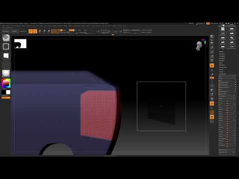

How to get clean edges when masking?
Thank you so much for any little help,
appreciate it!

Thank you. The easiest way would be to demonstrate it in a video.
Would that be possible?
thank you
