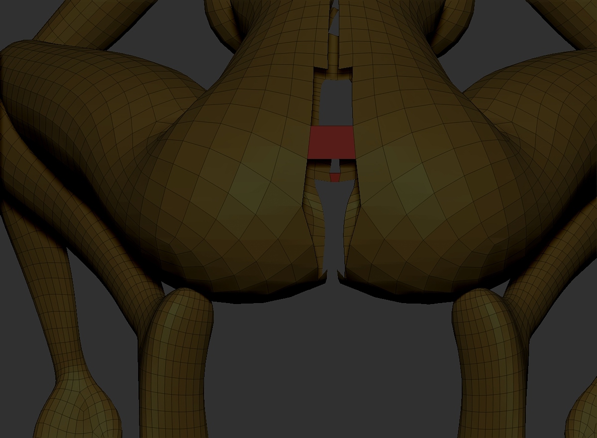

Hi,
I have a model that I wanted to be symmetrical so I deleted the half of it, mirrored it and merged into one subtool.
But now I have the polygons that are overlapping with each other.
How can I fix that without destroying the detail?
I try to dynamesh with keeping groups but then dynamesh created disconnections between playgroups.
I tried ZRemesh it but than overlapping polygons are still there.
I tried to delete it manually and then bridge it but I can get it done properly
 I can connect two-edged together but it’s too much of the process and the close hole doesn’t work properly on this model.
How should I approach fixing this kind of issue?
Please help me, I have no more clues on how to do it :(!
Best,
Michael

I did as you said and now I need to close the holes of the mesh. What is the best way to do it?
  • With ZModeler I’m able to bridge only two polygons at a time, right?
  • Close holes do not what I want (see screenshot)
  • And the CurveBridge - I think it does not the job or I miss something
 I tried to curve two oppositely edges with the shift holding but nothing happens. I think it doesn’t work on the holes properly.
Can you advise me with that? :wink:
I tried with bridging two polygons in some are and then filled it with ZModeler Close Holes. It worked okay, do you think it is the right way of approaching this model?
