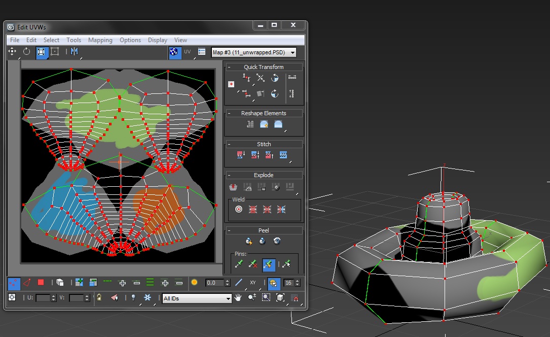

Guys I managed to import the object into 3ds max and its unwrapped. I got an issue tho, after applying the texture to my object in 3ds max, the texture loads upside down in uv editor window (refer to picture attached). Any solution to this? (aside from fliping the uvs in the editor). why the texture gets exported upside down from zbrush? something I might be doing wrong?

You just have to flip it somewhere(wherever works best for you). It’s been covered on here.

Also when you export your texture from ZBrush it needs to be flipped vertically for some software and not others, it just depends on the software, and I have no idea why.
As I understand it you don’t need to flip the UV’s so much as you need to flip the texture you generated.
A good example of this is I do not need to flip them for Blender but I do need to for OpenSimulator… and I almost always forget!

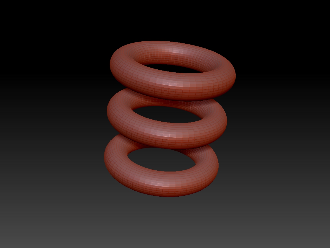

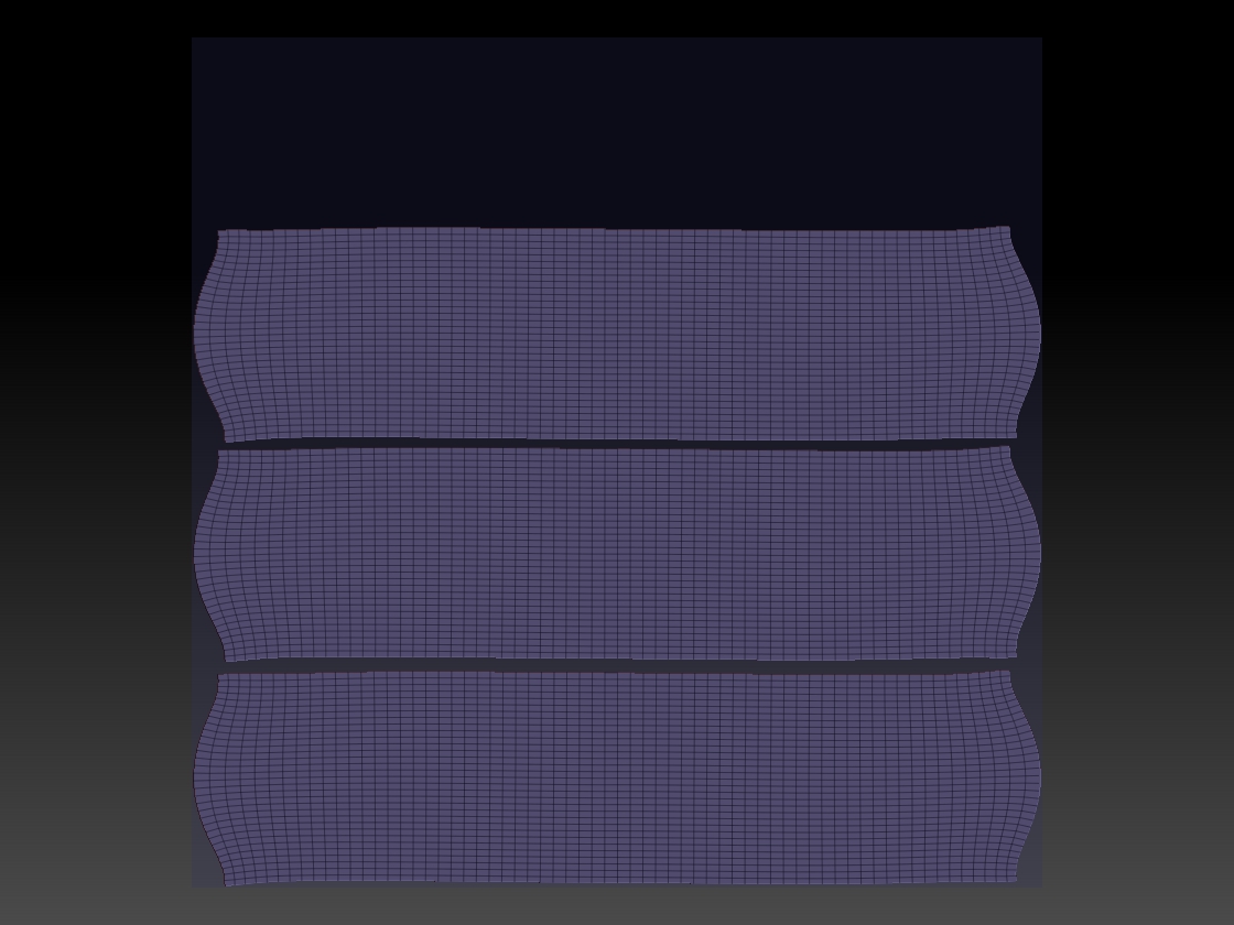

Its basicly a round thing with a hole in it. If you have more than one of them (as a single object) you will have what are called islands in your UV’s. This means that the textures you export for an object like this will have more than one part to it.
You could fix this by UV’ing each object separately I think.
Here is very much simplified view of this:
This:
Results in this:
Those three things are tori, one is called a torus.
