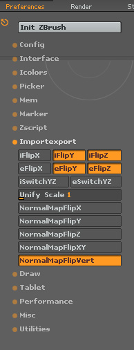

NB: You should set up your 'Preferences —> ‘Import / Export’ settings as attached…

thanks guys, it worked perfect!
once again, THANKS!
