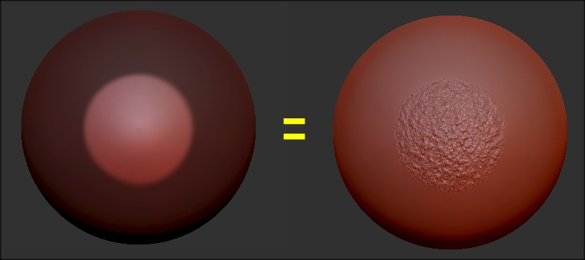

Maybe it’s this thread you are looking for?
No, that wasn’t it, but that might be a step in the right direction. is there some trick to get noisemaker to only fill noise on a mask?
EDIT: That looks like it should have been included in zclassroom! There’s amazing stuff in there!
There’s no trick to it. Noise will only be applied to an unmasked area, but you won’t see that until you ‘Apply To Mesh’.
I’ll have to try it again. I did it yesterday after doing some detailing on a mesh, and when i applied the noise, it applied to the entire subtool, as if there was no mask at all. I wonder if it might be a bug, though I don’t recall seeing that mentioned anywhere.

EDIT: I just tried it again, and it is working now. I might have been working too long in one zbrush session, and needed to reload and clear things out. (I was in it for about 6 or 7 hours yesterday.)
