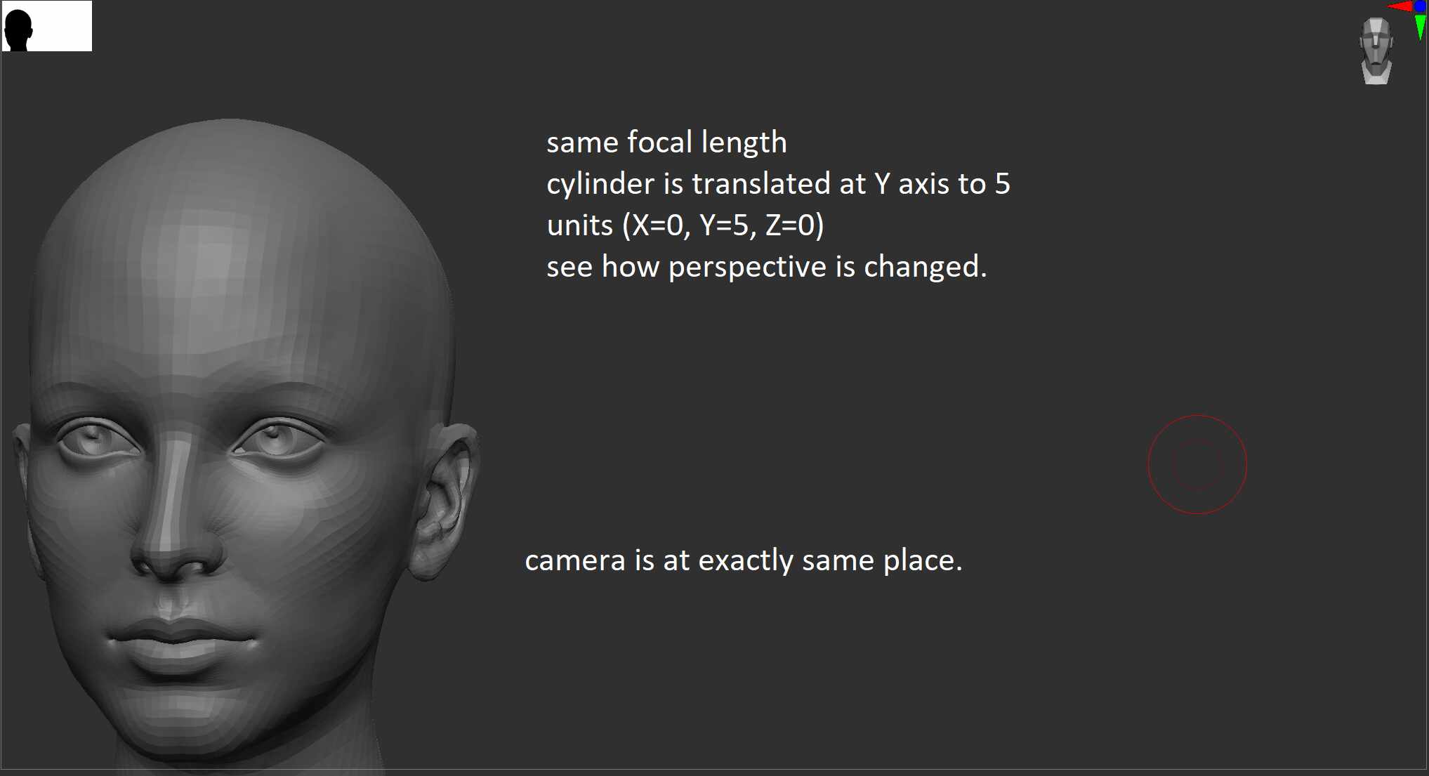

-then adjust position of appended subtool through menu(i used Y axis, as its the way i would build up my model)
-see how perspective changes

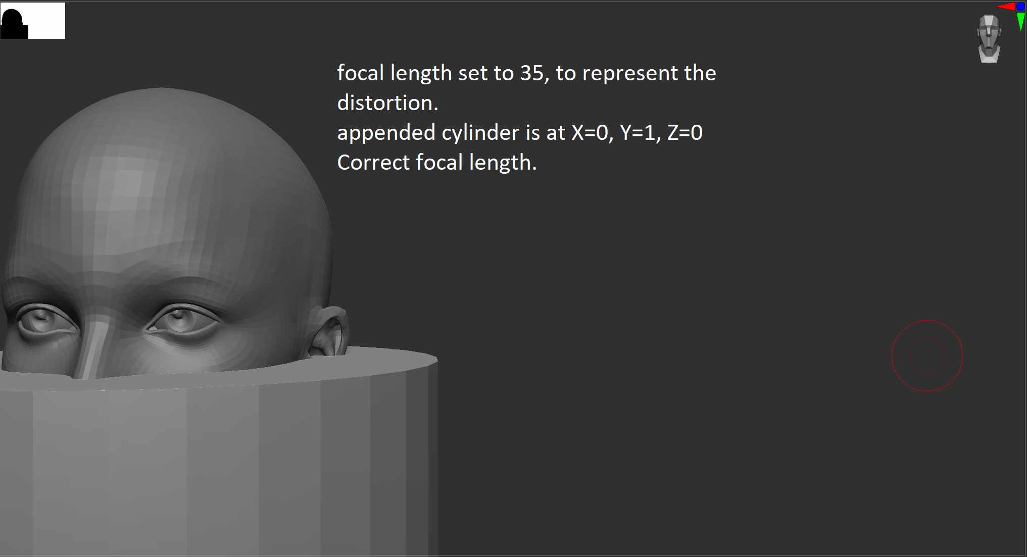

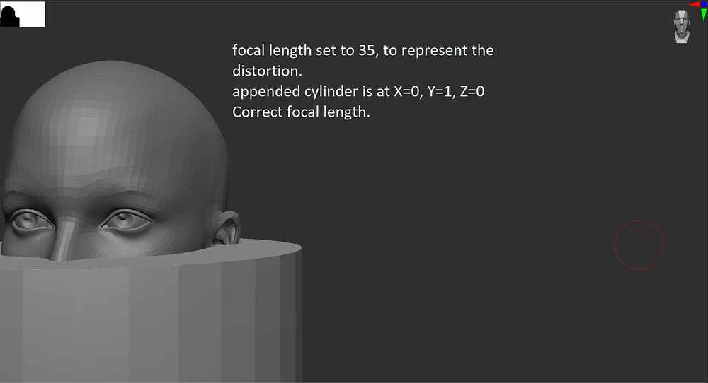

P.S. 2 The issue is also bound to document size/full screen mode and focal length value.
E.g. if i have document size at maximum available resolution of my monitor, it triggers perspective change at about 7 Y units. If i limit ZBrush window to half of my monitor (i have 21:9 ultawide) and adjust document size accordingly that window, it starts to trigger at 5 Y units(but this value changes if you have different focal length values).
Plus, AC is affected by focal length value. If i have focal length at 35mm as on the screens, in current example perspective change starts to appear when cylinder is translated to Y=4 units. If i have focal length set to 50mm, it starts change at Y=5 units translated.

Two screens:
