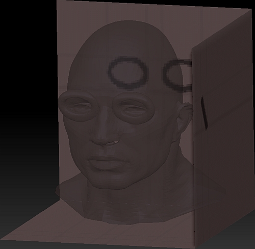

Shadowbox would be very helpful with this.
Duplicate your head in the subtool, press shadowbox and then ctl drag to remove the second head mask in the shadowbox to empty it . Draw the glasses with shadowbox masking using the head as a visible subtool guide for both drawing and positioning the glasses.

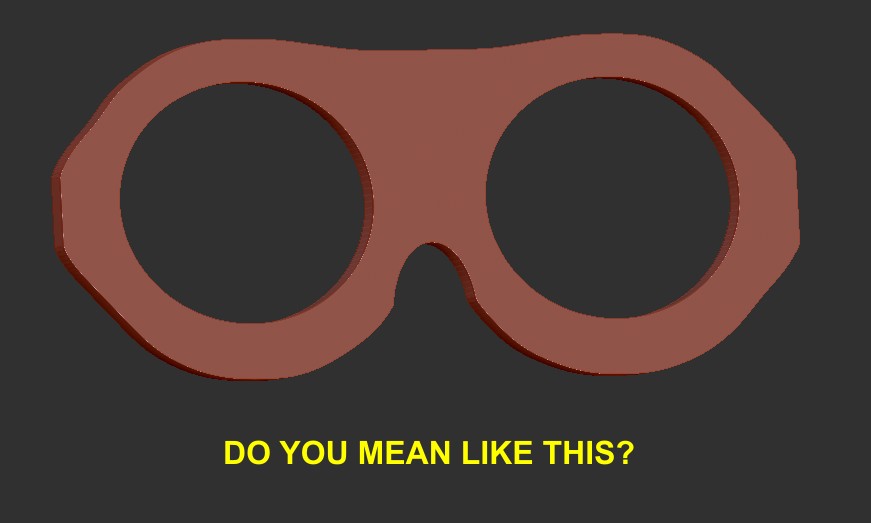

Here’s a very rough example:
Hey zber2, yeah, that would be a good basic example of what I’m looking for with those red goggles. And thanks Nancyan for the shadowbox idea, brain fart on my part for forgetting to use that. However I would like to be able to slice a hole in not only subtools made from shadowbox but also from tools that I make from primitives or other shapes.
