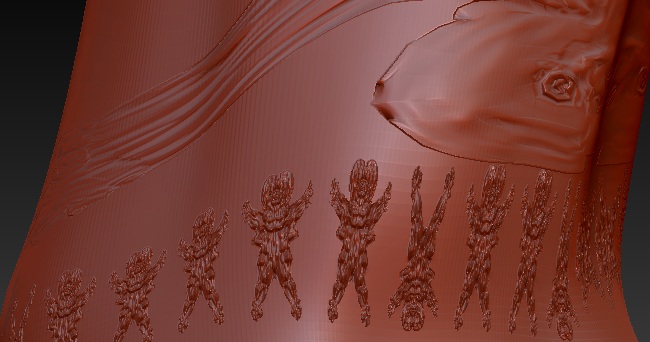

ok…i tried and what happened is very bizzare:
[probremaco.jpg](javascript:zb_insimg(‘209315’,‘probremaco.jpg’,1,0))
And i got a bit confused after i imported the obj file…if i work with morph brush nothing happens…
Maybe i’m doing something wrong in the beginning…
