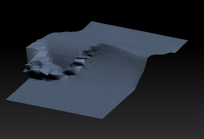

Hi I’m new to all this zbrush malarky. I have made a sculpture using the 2d-plane. I eventually want to print it so will have to close off the sides and bottom. How does one go about this?? Untitled.jpg
As you can see from the image I will need to close the two sides off and add a base. Is there a way to add points to a mesh??
Any help gratefully received…
You can’t do that with a “Plane”. You should have used a squashed cube instead.
You can probably fix it by Retoplogy- Appended Zsphere Method.
