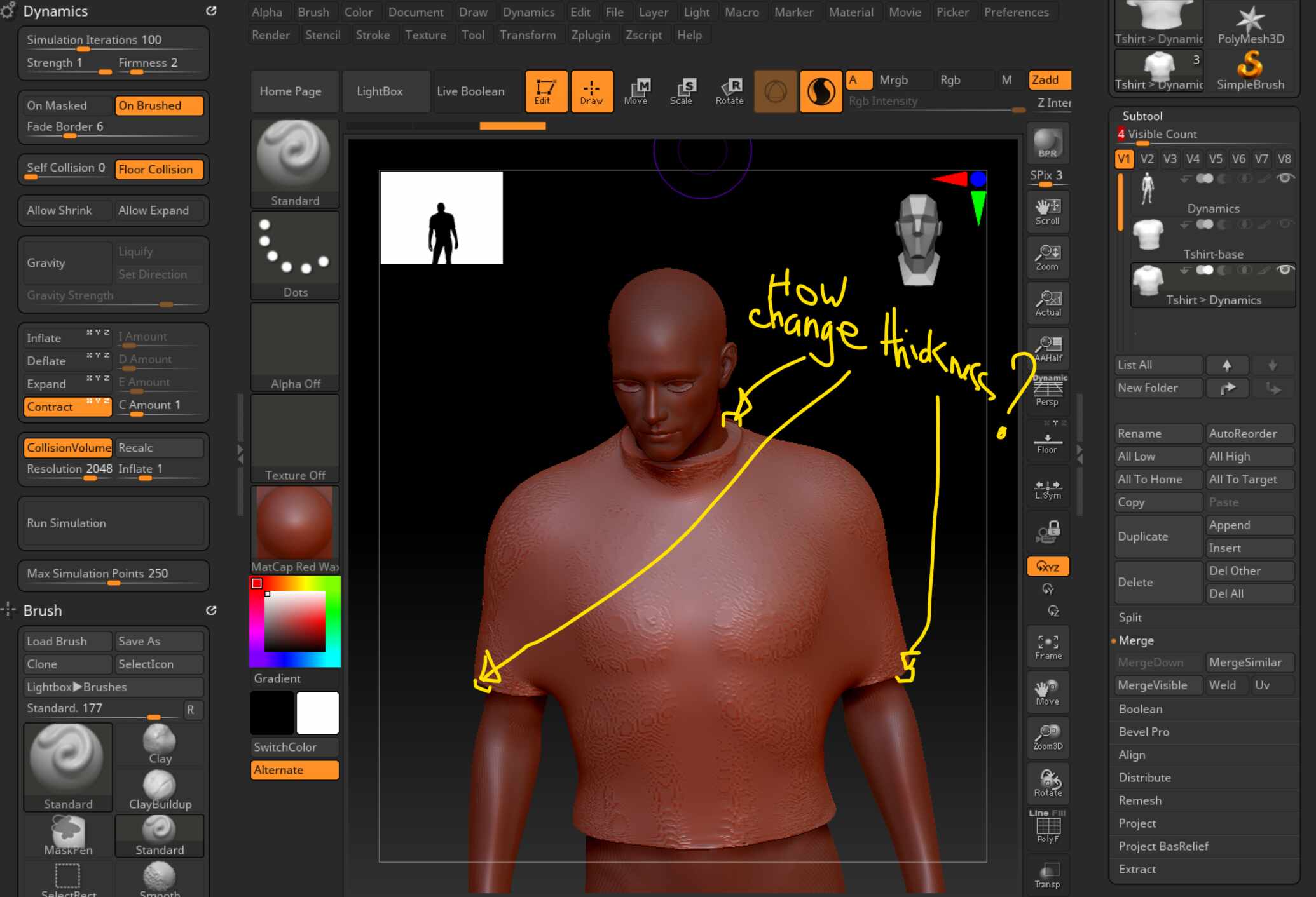

How to change the thickness of Dynamics simulation
Hello
I try to make some cloth but the result is very thick, is-there a way to change the thickness? :nerd_face:
hi @MrCedric, try to just use one sided surface and use the dynamic subdivision with thickness enable and then running the dynamic simulation. Do not forget to press Recal button before.

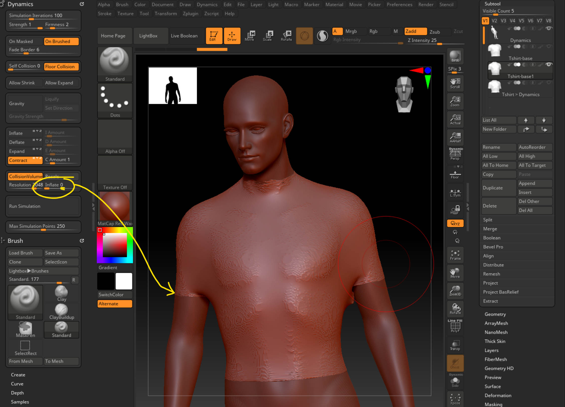

I found, in fact by default there is an inflate set to 1, so I write 0 and now it’s fine :grinning:
