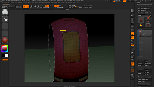

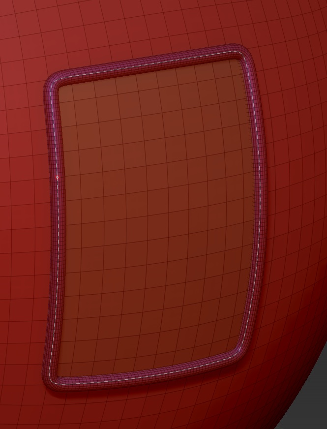

Hello. I am trying to project a CurveTube brush along a stroke path using the curve function. When I click the curve with the selected brush, the shape I am trying to achieve is skewed because the origin of the stroke is in the corner, causing that corner to look different than the rest. I have an imaged attached. If I was able to change the origin to a straight part of the path instead of the curved corner, it would be fine. How do I change the location of the stroke origin point?
In the future, could you please post bigger images. You are allowed 500 kb image file size. Thanks!

I can’t tell from your small picture, but if you’re trying to insert a tube around that yellow group, you should be able to click the frame mesh button in the stroke palette with groups selected.
