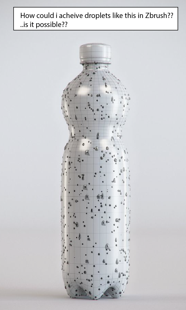

Does anyone know how i would approach adding droplets/condensation to a bottle in zbrush? I understand this is normally done in other 3D programs like Cinema 4D. Just wondered if this is achievable in Zbrush? and how you would go about it?
I have attached an image of the droplets i want to create.Screen Shot 2017-10-15 at 2.14.24 pm.png

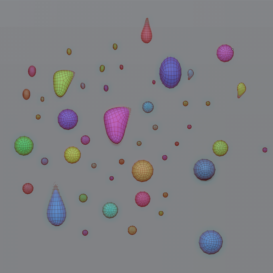

Initialize qgrid, set resolutions on 100 and just model droplets (sorry, sculpt droplets:D)
You can use any of simple alphas already in zbrush, but dont need them.
Just sculpt everything on low res. level so smooth subdiv. will do all the rest.
Here is sample made in 2 min, just standard, and smooth brush (added reflect mat for some preview effect) :
So something like this to make displ. map (alpha) just go to alpha -> grab doc (plane must cover whole canvas)
Depending what you want, you can sculpt on bottle, make tillable alpha, make alpha that will cover whole bottle…

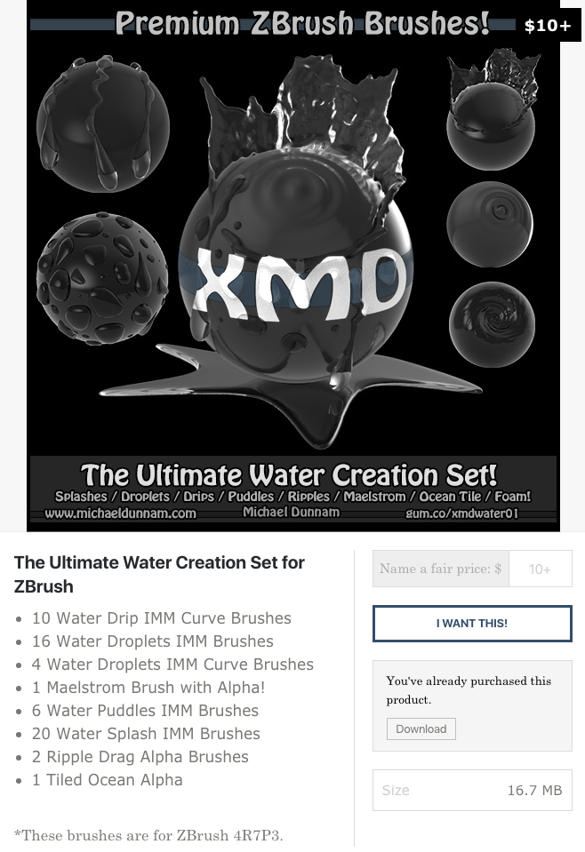

Thanks for the quick reply. Great idea. I also thought to create droplet IMM brushes. But came across this brush set by Michael Dunnam for $10. Would just need to keep the droplets as low poly as possible, as there will be hundreds of these little droplets I will need to keep polycount down.Screen Shot 2017-10-16 at 9.00.48 AM.png
i think this is the way…using insert brush
