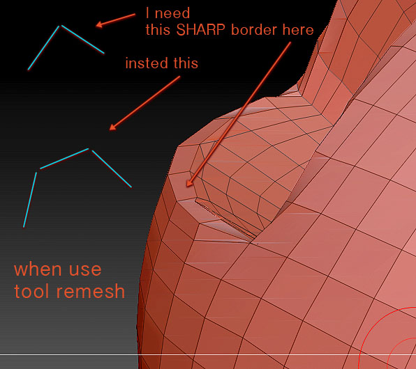

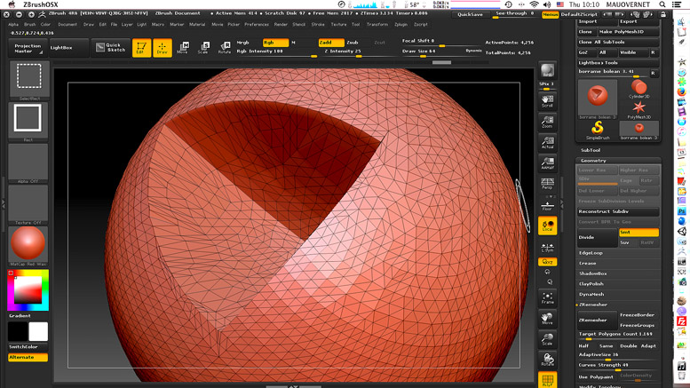

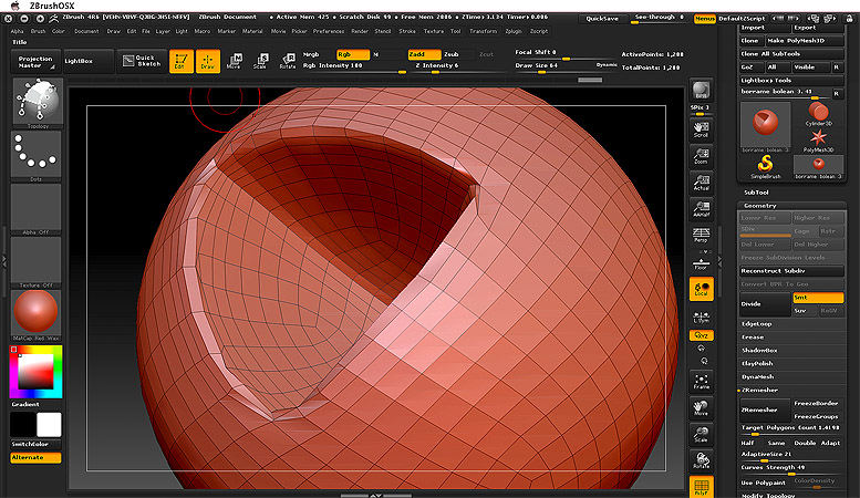

hi …
just toknow
how make a very sharpened edge when use the tool REMESH to reduce the mesh
here i leave (in secuence) tree pictures
to explain better what i need.
and any help will be apreciate so mush.
hi …
just toknow
There are 3 planes that create that indent; try giving each plane it’s own polygroup. You can probably do this automatically by using Tool: Polygroups: Group By Normals.
This should give you 4 polygroups; 3 for the indent and 1 for the rest of the sphere. Once you have this, try zremeshing it with the “Freeze Groups” ZRemesher option toggled on to see if it makes a difference in preserving the angles.

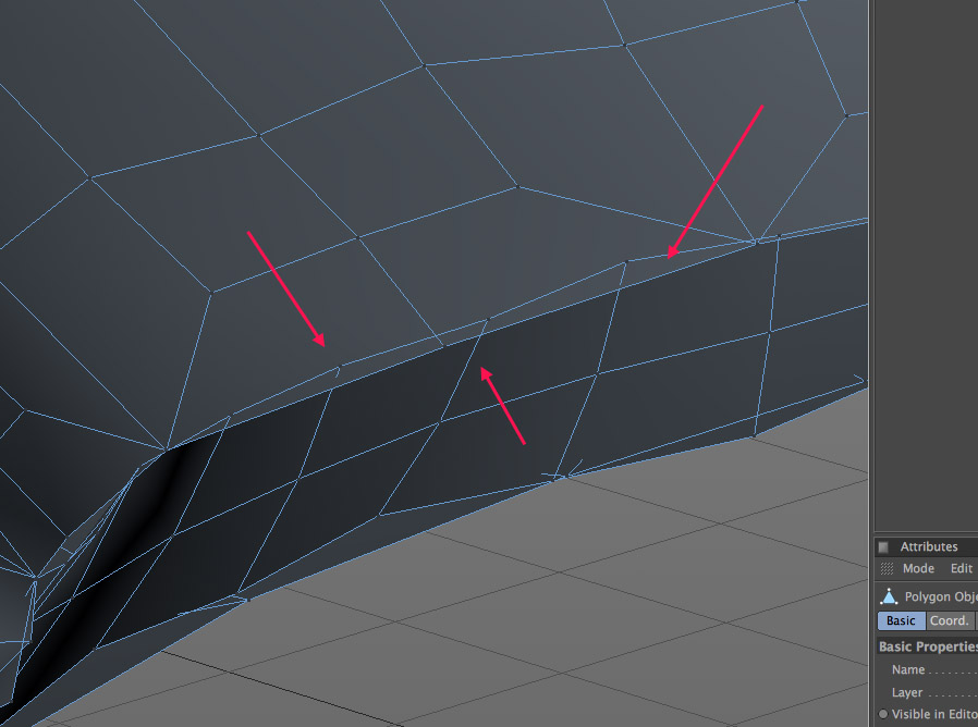

I have solved to export a single object, but always the points are not welded,
how can I do, to export a single object and the points exported welded to the nearest point, and NOT generate holes whwn export
as shown in the following picture !
any help will be apreciate so much
