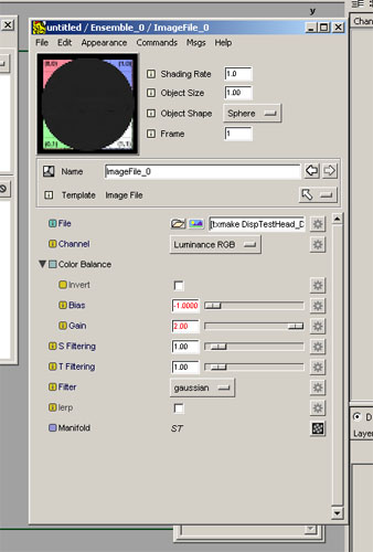

I havent touched Renderman in a year and not all that much when I did but as I recall create a Combine displacement appearance. near the bottom you have the option to link a file. Do this and you will have access to a new screen with the image file attributes. Set bias to -1 and gain to 2 (or use the settings in the link attached, one of them should work)
Make sure you use txmake to convert your displacement map to a .tx file you can access this with the icon next to the file path.

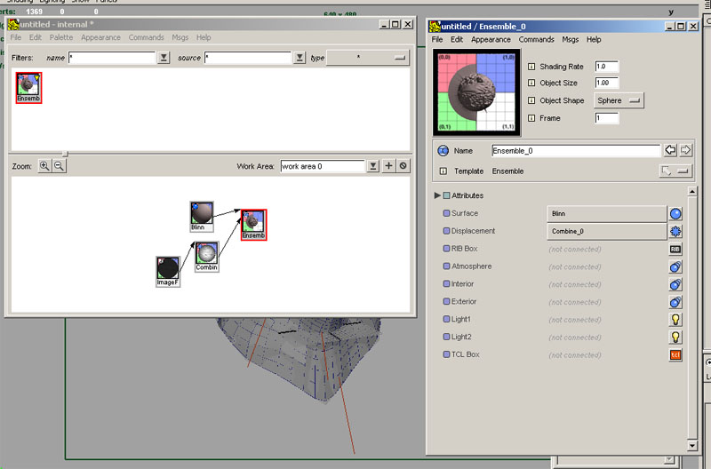

i have try to used but it’s not working
here is screen capture of my setup
maybe try the settings in the screenshot then on the link I sent… otherwise check the Rendering thread link I recall seeing some Renderman info in there too : )

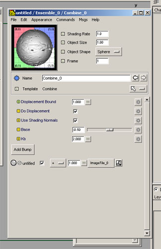

i have question in your combine appearance
the Kb you set at 200 or 2.00
