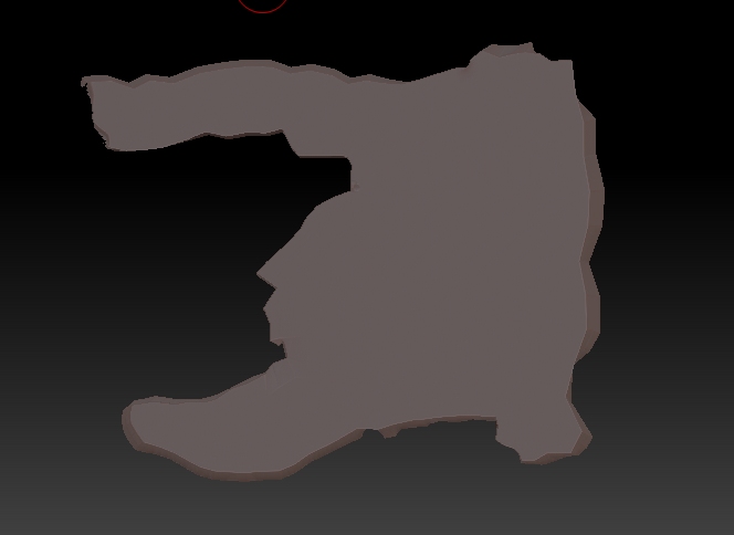

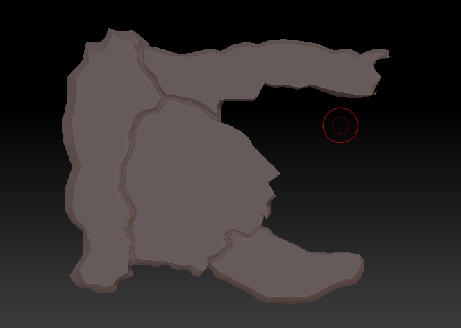

So if i wanted the underside of this continent to be the same as the top is there some kind of trick I can use? Realign an objects symmetry perhaps?
You could mask the side you want to keep then use Tool>Deformation>Smart Resym to mirror the detail. Make sure that you choose the right axis.
