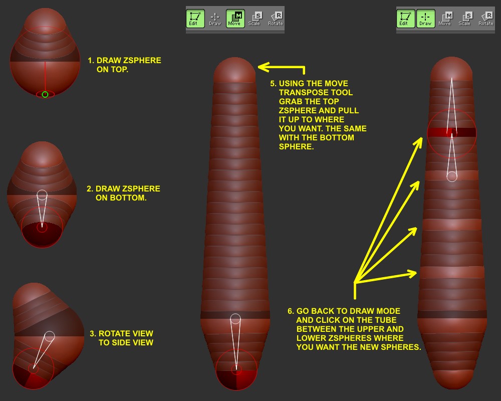

you need two sets of sym turned on. x and z typically.

Zber2,
This works fine of course. I guess maybe I just didn’t realize that between creating Zshperes in these tutorial, the authors were (secretly) adjusting the y axis without showing that in the tutorials?
See, I assumed that you could follow them step by step - and that I was doing something wrong. Well I guess not adjusting the Y position as you show WAS wrong.
Sorry to be such a newb, and thank you for the beautiful illustrations Zber2!
