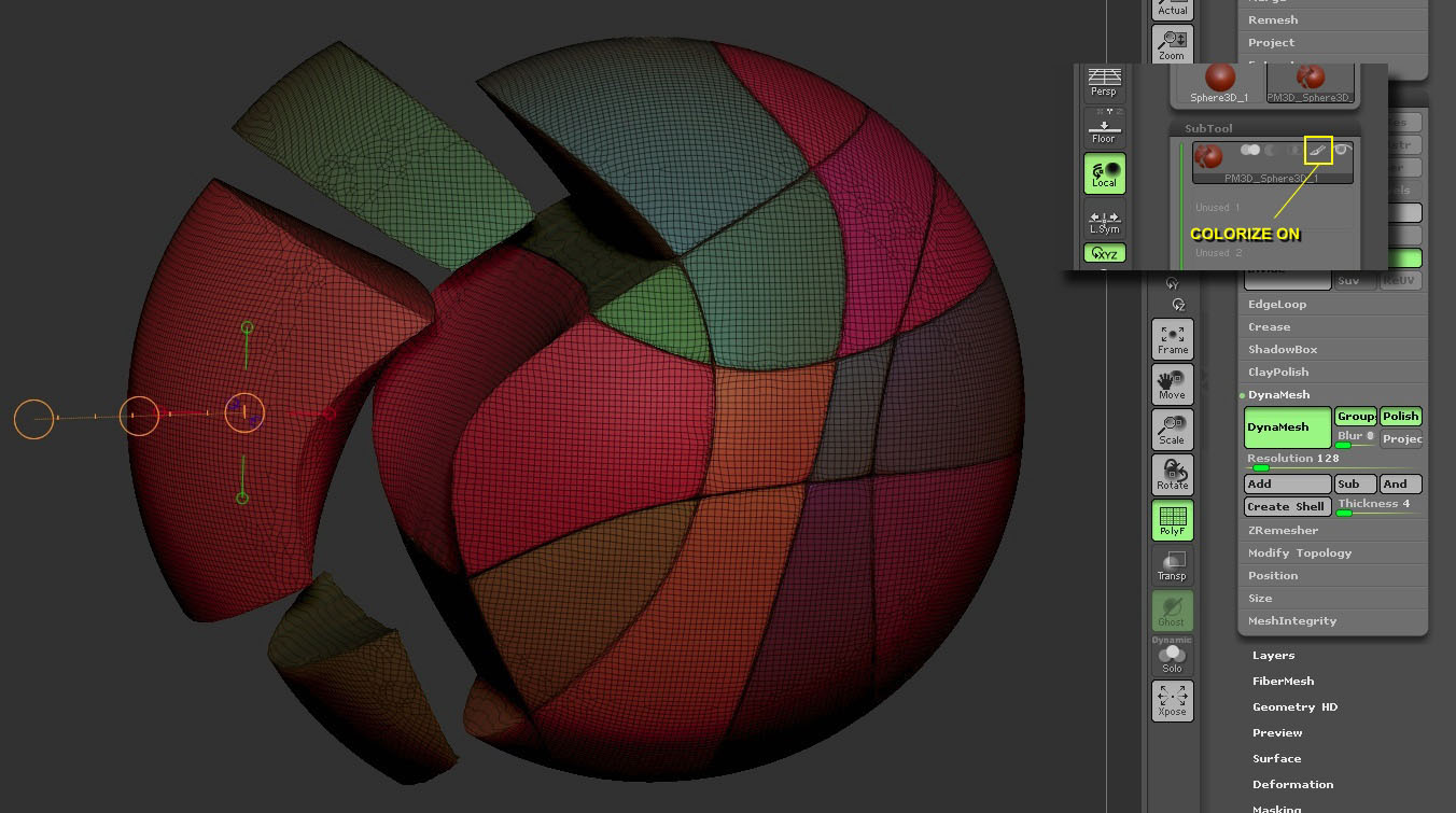

One of the fascinating things about Zbrush is how it can do something that a regular 3-D program would take hours to do. Slice curves is a boon for hard surface modeling however I feel lately with the latest ver of Zbrush If I cut up an object too many times the edges are really ragged and look pretty bad. Is there a work around? I have blur off and group option on. Polish on or off still yields same result but seems to be a little better with it on.
turn on polypaint.
I did… I am able to seperate and I just tried it now… but result is still the same.

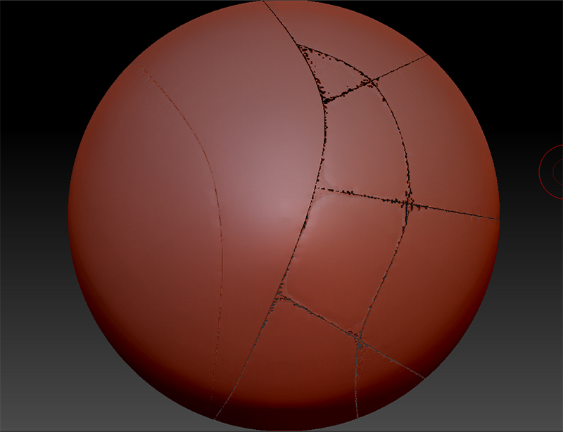

The more resolution you have, the better the results will be. There’s probably a way to make your shape by extracting masked areas with thickness.
No matter the resolution… result has been the same. As soon as I hit Zremesher (with the paint brush option on …Polypaint) it creates all these jaggies. I’m sure there is a work around, some things in Zbrush can drive me nuts others it’s pure bliss.

You should DynaMesh 1 slice at a time and not multiple slices all at once. It’s best if you re-DynaMesh after each subsequent slice.
I think that was the ticket! Thanks so much… I just tried it works… however as I remeshed my final cut it seems to have locked up. Thanks guys for your input, really thankful ya’ll chimed in.
