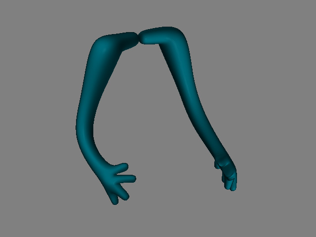

Thanks to everyone for replying. I’ve actually tried to clone and mirror the object, but everytime I do, the result is a reversed object that I can see through as I rotate it. I’ve included a picture to demonstrate the result. Anyone know why this happens? What am I doing wrong? Thanks again.

Thanks yet again for the reply. I’ve created a new picture to illustrate my problem more clearly. The arm on the left is the original, the arm on the right has been cloned and mirrored. Notice how the fingers are kind of distorted and transparent on the right arm? I get these sorts of results when I attempt this process.

Somehow your normals are getting flipped. This turns the object inside out, so to speak.
Press Tool>Display Properties>Flip to reverse the normals so that they face outward again.
