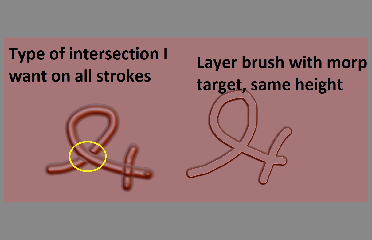

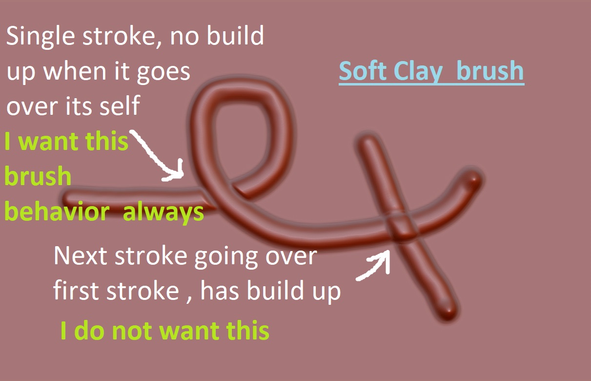

Hi I am using the Soft Clay brush, this brush has the property that when drawing it will not “build up” or ride up over itself on a single stroke if that stroke intersects it self. But when you go over or intersect a previous stroke it will ride up over the previous stroke.
I am looking for a way to set this brush so that it will not build up over previous strokes.
The only thing I found on this is the following, but this setting only controls build up on the current stroke.
Buildup
When applying brush strokes, information is constantly picked from the canvas and used to update the stroke.
If Buildup is turned off, the current brush stroke is ignored while picking the information, until the mouse/pen button is released.
If it’s turned on, the information is picked both from the canvas and from changes made by the current brush stroke.
How can I turn build up off for all strokes?
