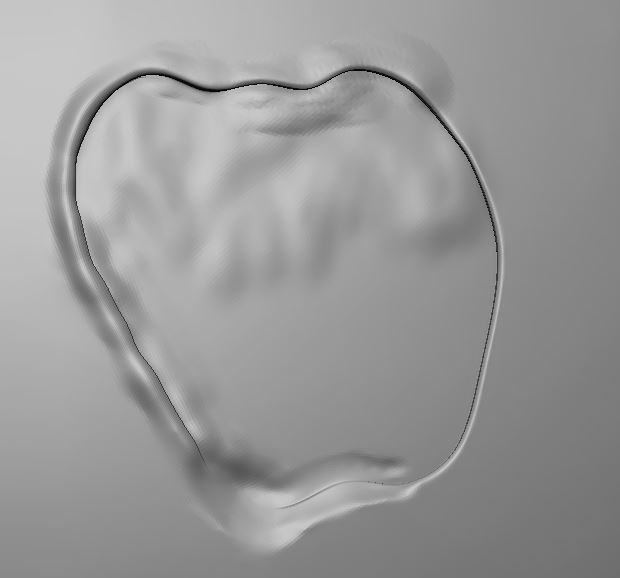

I’ll try it out with some pebbles alpha, any ideas how to correctly push out the geometry like it was stamped, without inflating masked regions?
Mask by Cavity should work. Store a Morph Target first so that any masked edges affected can be restored by rubbing the Morph Brush over them.
I still can’t get it right, tried to make it with cavity mask and morph, can you send a link to a tutorial? maybe I am doing it wrong.

I masked, panel looped, then I can inflate how I want and where I want, I made a test on a sphere.
Well done. I thought it was the dotted surface you were trying to get rather than the edge. Sorry I misunderstood.
I think the dotted surface ill make it with a normal map or maybe a noise map.
