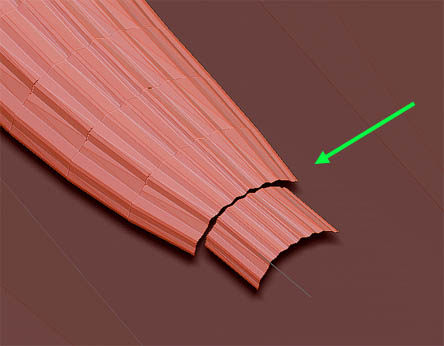

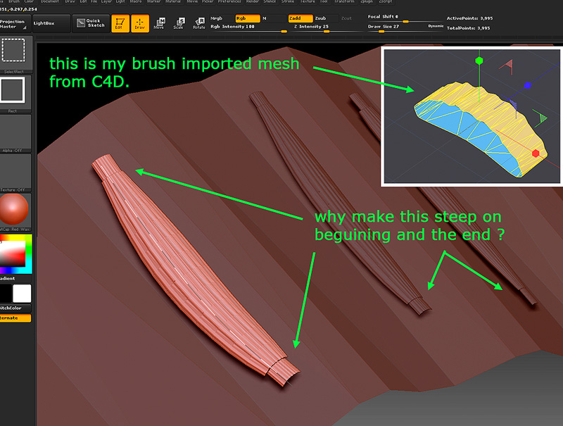

i am making muscle brush for anatomy arm
but the brush on the beginning, and end make a steep and i need to avoid this tier steep.
my question i mean:
how avoid the sharp tier (steep), in the beginning, and end of the muscle brush
here is a picture
please any help i will apreciate so much.

If this is an insert mesh brush you created, then when you insert the object it is going to be just like the original model you used for the brush. So you need to smooth down the ends of the muscel first then make the brush. Try using Zremesher or Dynamesh on the model, then use the smooth tool, then make the insert brush.
thanks i will try …
really thanks a lot ! :slight_smile:
