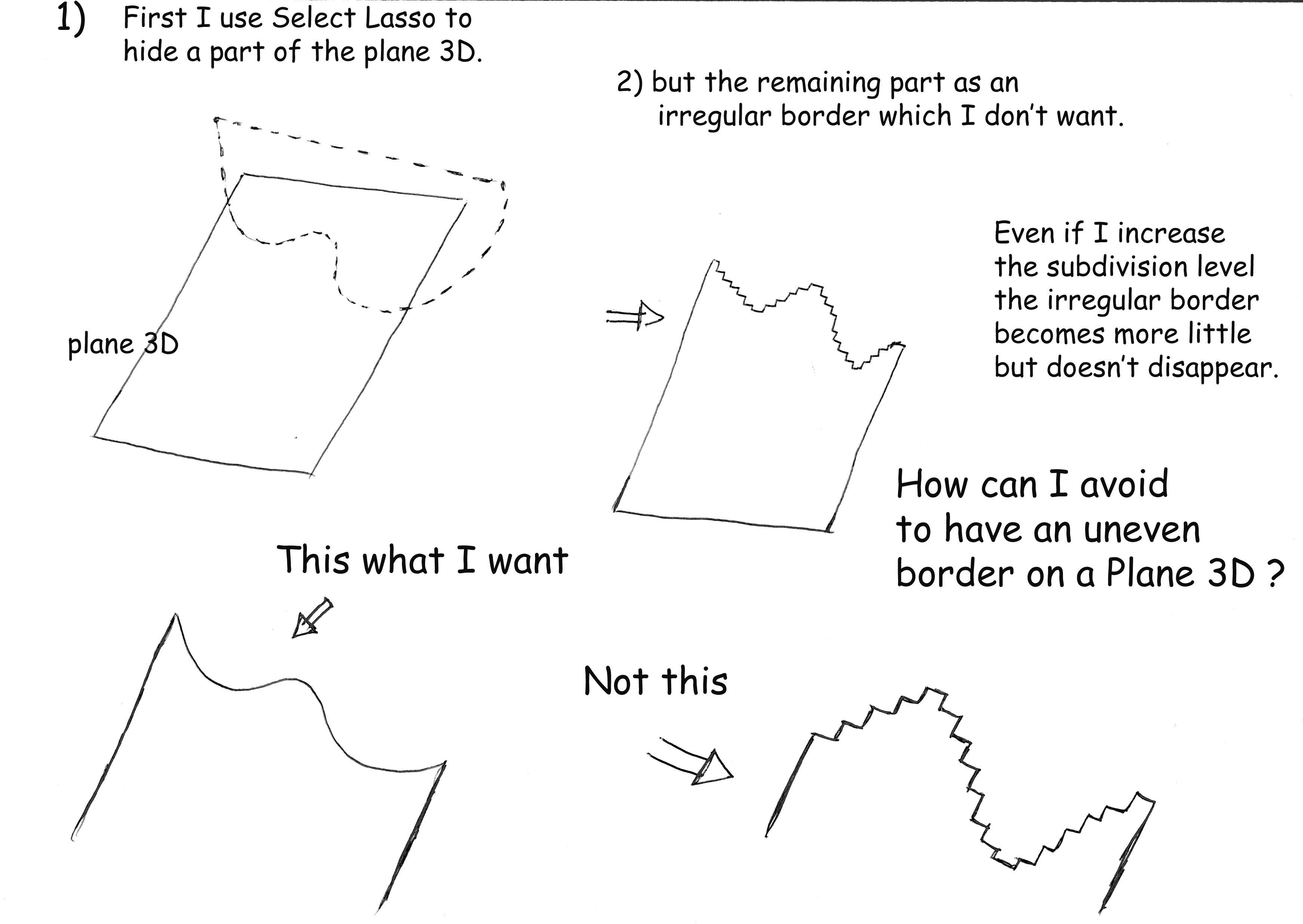

I have a problem with plane 3d. Please see attached drawing. Can you help me?
I hope someone can give me a solution.

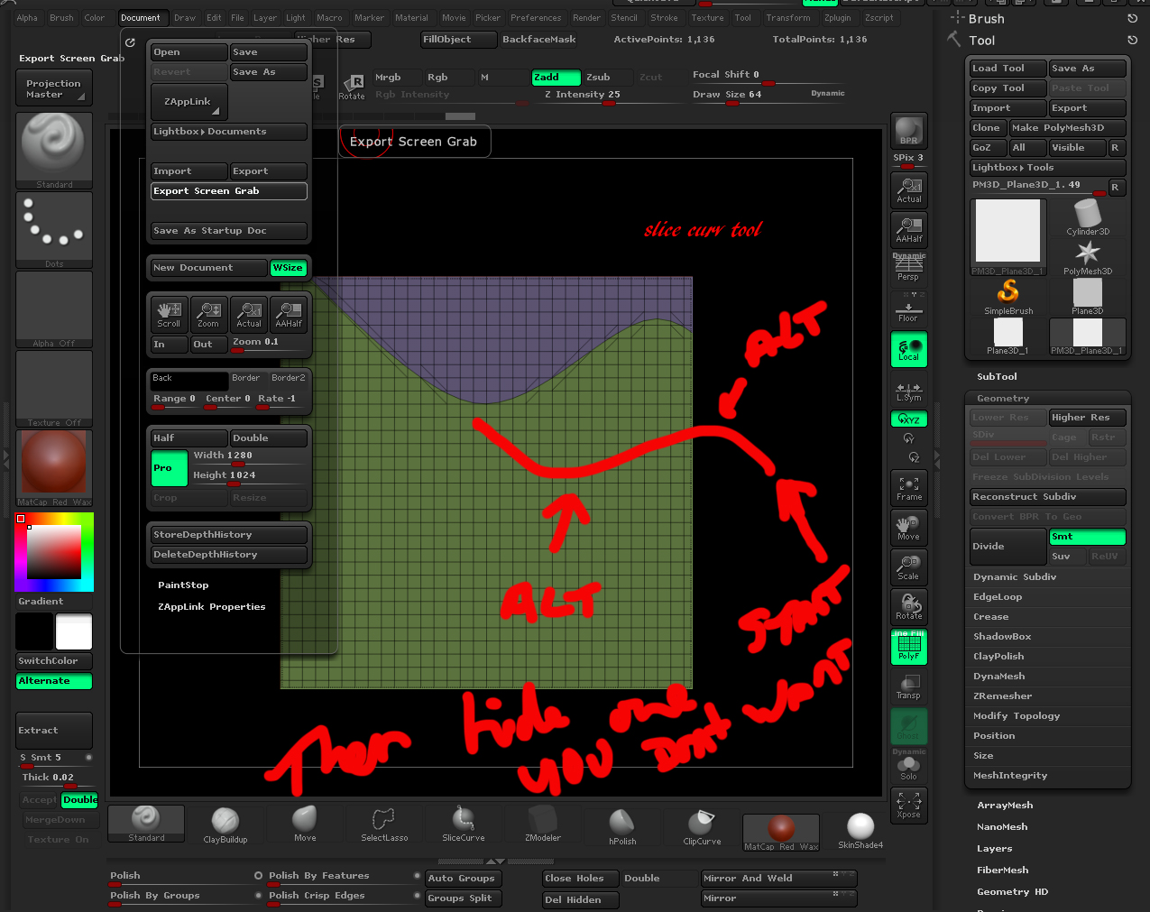

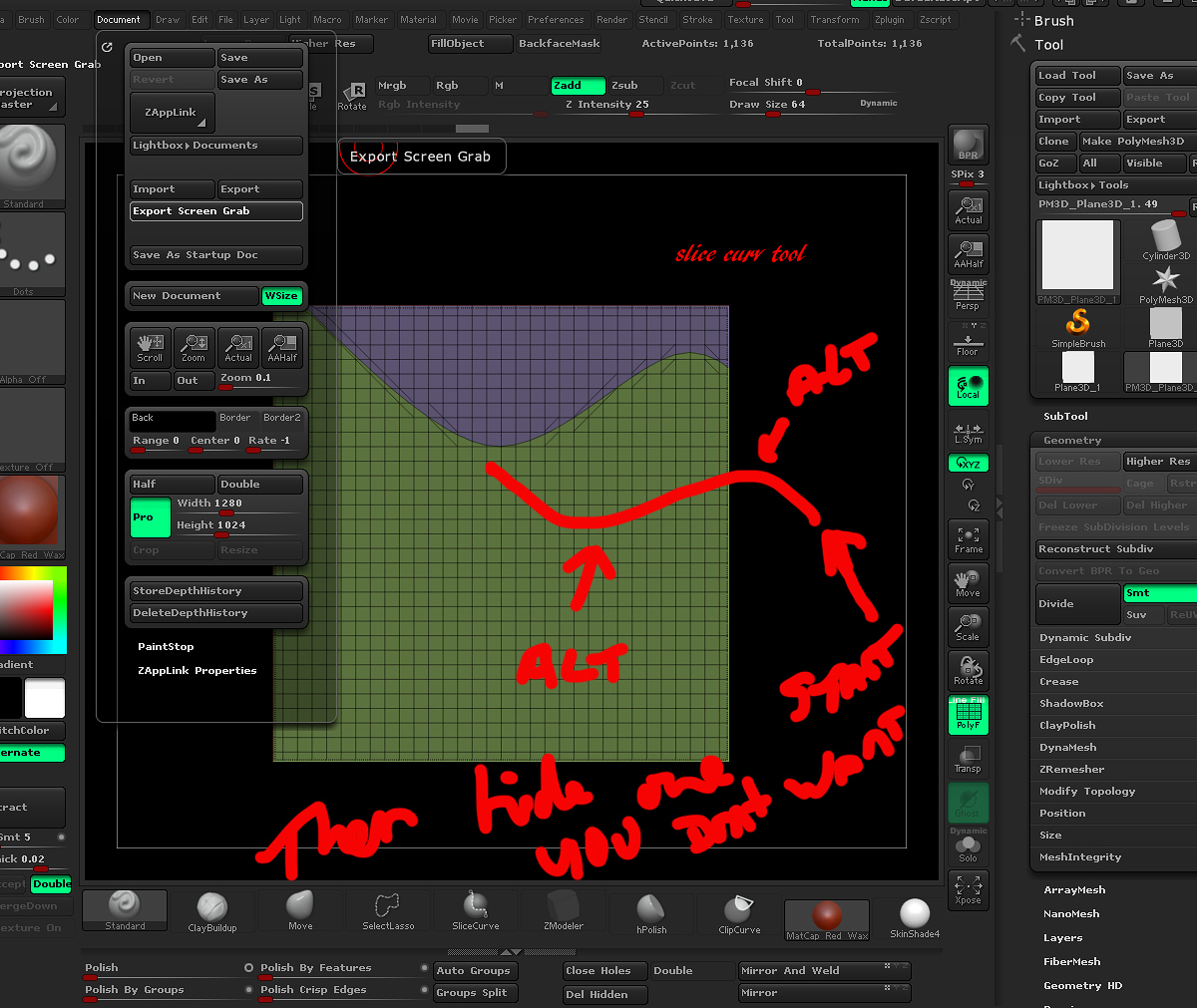

Ok see image choose slice curve tool,make your shape and that will give it its own polygroup,then delete the group you dont want hope it helps
Dear Fonty,
I really want to thank you for your prompt reply and for your very clear drawing!
Thank you!
