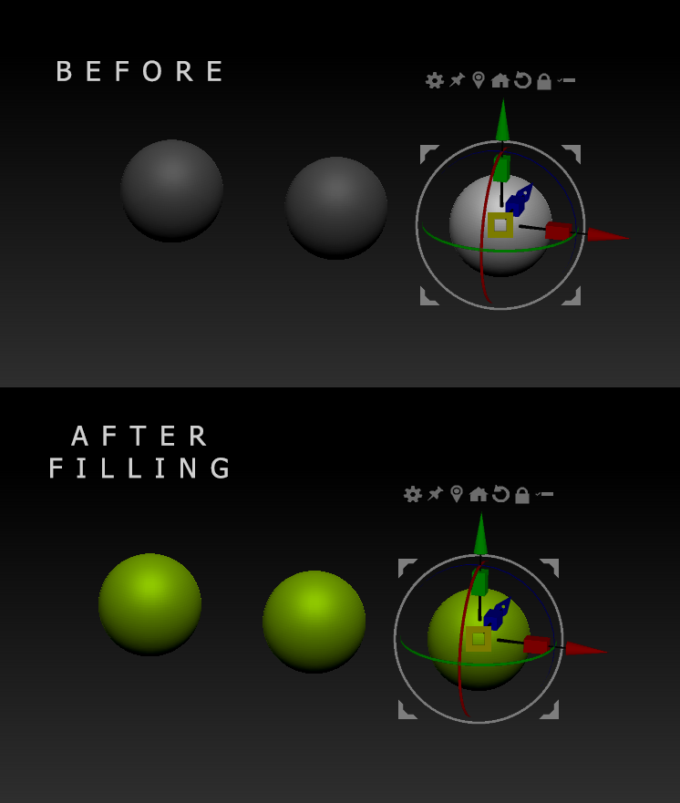

Hello, help please. I fill subtools with a color and then “Inactive Subtool Dimming” do not work with these subtools. The problem is that I can’t return them to previous state, before color filling. When I fill objects with white (defaylt color) it doesn’t change anything.
2020-04-12_17-54-58

As far as I know, it’s always been like that. As soon as you Fill a subtool with color, it turns on Colorize on that subtool. If you want Inactive Subtool Dimming on that subtool, turn Colorize off (paint brush icon on subtool). Following is from the Online Docs.
The Inactive Subtool Dimming slider controls the shading value of the inactive subtool’s materials. If this is set to .9 then the inactive Subtool material will have a greater intensity and a lower value will tend towards black. Filling a subtool with color, or displaying a texture map on a subtool, will disable this effect.
ZBER2, thank you very much!
That’s what I need.
