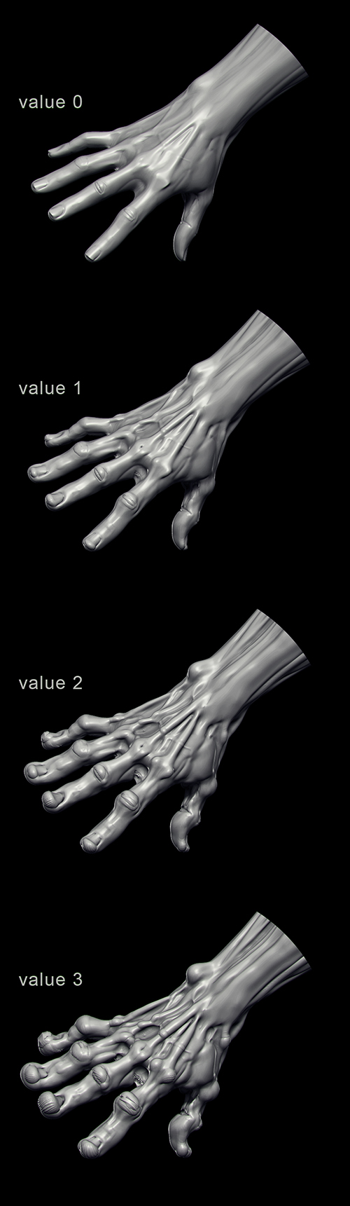

Hi Poda,
sorry maybe is because my english … the positive and negative values is possible to change in layer visibility slider. So when you ones have created dispMap, you create a new layer and then apply the dispMap to mesh. So now you can set the intensity of this layer. 2 is 200% and -1 is -100% of layer contend intensity. Hope is clear now.

Hey Svjeetam,
Your English is just fine! Understood what you did. I just do not understand why you are doing it. What do you need the positive and negative versions of the displacement map for?
Ok, the minus value was just for illustration, like what is possible. In this case, i wasnt happy with visual of the structure, espetialy with hardnes, intensity of structure on balaclavas in the relation to whole composition. I felt like is too soft detail. So i used this trick to increase intensity of structure. Somebody asked me how i did the balaclavas, so i did this review.
But, generaly, this is very usefull trick. You can very easily work with plasticity on your model. You can use it local, if you use mask tool, or copy subtool and projection tool. Is just cool trik for experiment.
Here are few screens for demonstrate on example. As you can see the value 3 gave very expressive result. That may be usefull in some case.

Svjeeta, I get it now. Thank you very much for taking the time to re-explain! I thought it was part of some bigger process… Instead, it’s a way to push, reduce or change specific sculpt details. Great idea!
