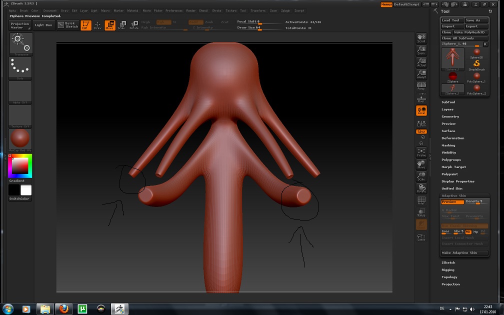

Hi guys, i’new here with a big problem.
I make the tutorial on the pixologic site. (octopus)
But i have a problem…The end of my zspheres looks like cut off. What can i do?
Without seeing the actual zspheres it is difficult to say what is causing the flattened ends. But I would guess the last zsphere on each tentacle is too close to the second last zsphere on each tentacle. Try moving the last zsphere further away.
You could also have accidently turned the last zsphere into a magnet zsphere by ALT clicking on the link between the two last zspheres. A magnet zsphere that is too close to the parent zsphere will cause a flattening effect. ALT + click the link again to turn it back into a normal zsphere.
Indentations ( one zsphere inside the other ) and magnet zspheres are only available when using Classic Skinning.
