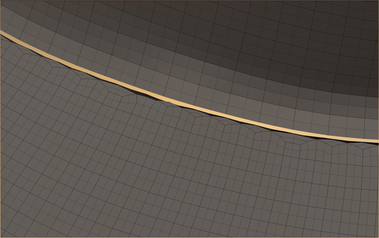

Help - Zremesh split my hat into 2 parts!
Can I use a dynamesh and morph it to this shape I already sculpted?
If yes, then how?
As you can see the geo no longer matches up on the 2 parts.
This is a hat that I originally created in Maya with 2 cylinders and half a sphere. The brim was a separate cylinder from the main part of the hat.
I thought I properly welded the verts and combined into one object. After remeshing in zbrush however I now see this gap. I filled in the opening that was on the inside of the brim so now the brim has a top and bottom but the main part of the hat just has one wall.
Thanks for your help.
curve bridge should be able to fix that
Thanks so much!
It did work - and was quick and easy!
