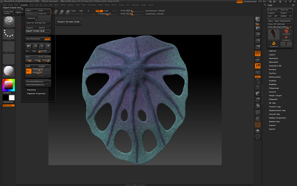

I’ve spent the last couple days building an alien leaf model and am now finding that I cannot UV it. I tried every combination of the ‘standard’ UV tools in ZBrush as well as UV Master and they all seem to hang when working on this tool. I’m wondering if someone, anyone, here can take a look at this tool and spot what be wrong with it. Here’s a screen grab showing the tool:
As you can see, it’s nothing all that complicated. It’s low poly count, only 400K polys. I can’t understand why ZBrush is crashing trying to UV it.

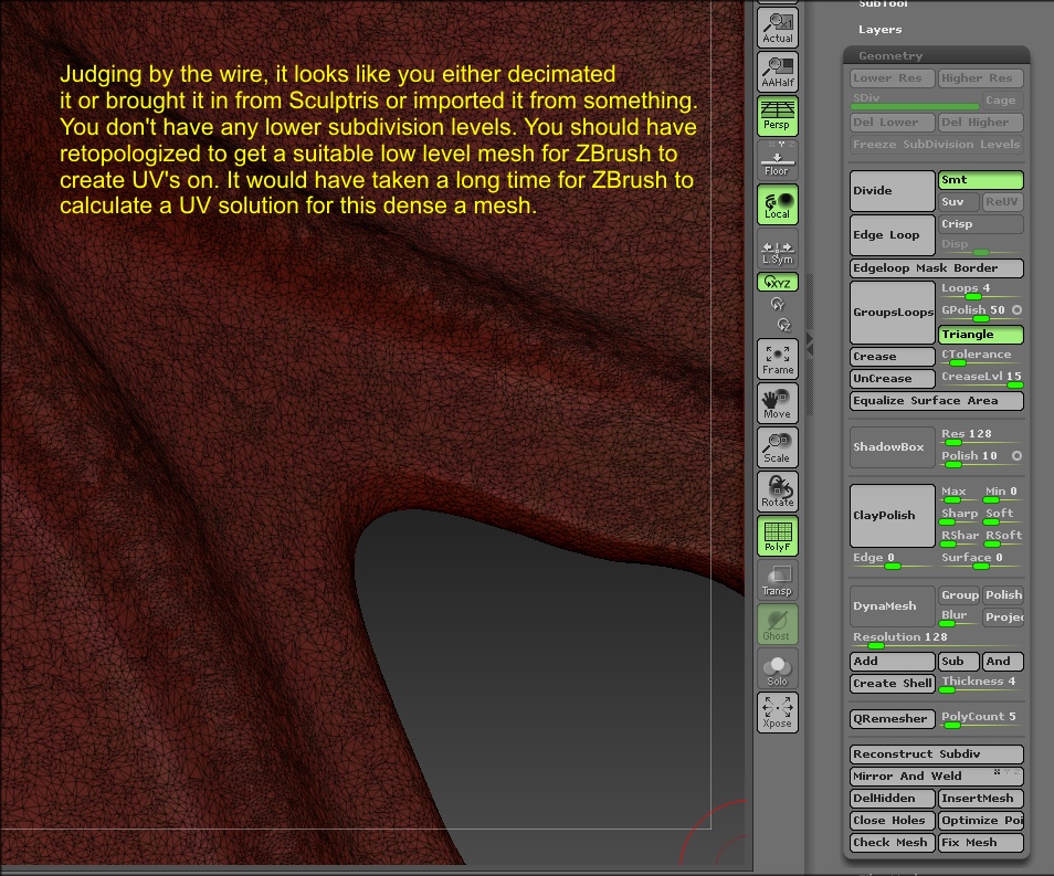

Update - a friend of mine got it to work by exporting out to Modo, UVing there, and importing back into ZBrush. So, immediate problem solved, but I’m still curious to know what it was about this tool that was apparently too much for ZBrush to handle…
Dan
Thanks for looking at this, zber2. I should have mentioned something about making the tool. This was done completely in ZBrush, with the main flat areas created with the curve quad fill brush, and then dynameshed a few times in the process of adding various structure.
I’ll certainly look at the retopo option…
