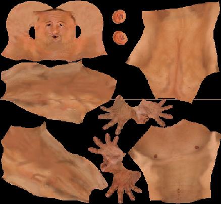

  1. i get a coloured line going straight across my texture whenever i create it that is not in the polypaint and there are no stray UVs to cause this…
    [v2_torso_13-TM.JPG]

The colored line across your map is from the seam overpaint in Zbrush. Your UV’s are too close to the boundary of the map. Simply move in that one section on your map to the right (+x) a bit and that should fix that problem.
I can’t help with issue 2 as I don’t use Maya and you seam to be having trouble with the Maya Mentalray settings.
