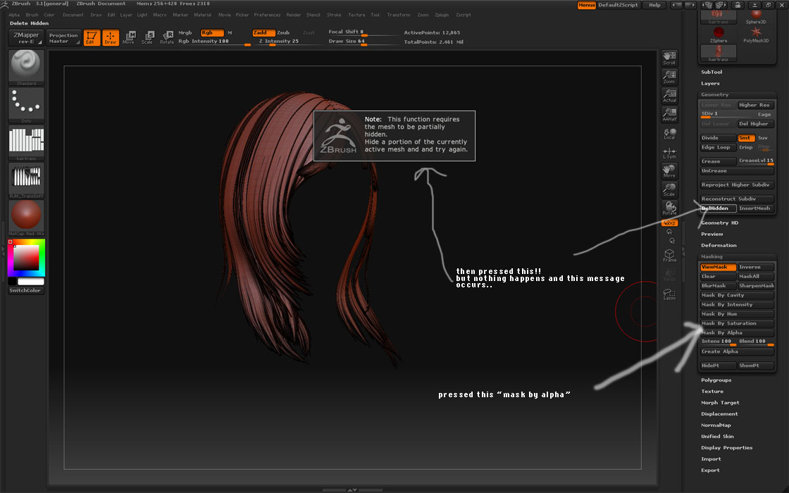

Hello, i still have the problem.
i think yu git it right what i wanna do…
i have hair exported from poser and now wannamake in zbrush…
i has transparency map and color map…
so when i put transparency map the hair shape is fine but as soon as i put off the shape is somewhat squared…
now i cannot put both textures together in zrbush…
so i want the shape of my hair as seen with transparency map…
when i used the method of masking said by aurick still gives problems…
see the image ive attached…
it will give u better idea!
pleas help!

after you “mask by alpha”
hit “hide PT” at the bottom of tool>masking
Then you can delete hidden.
